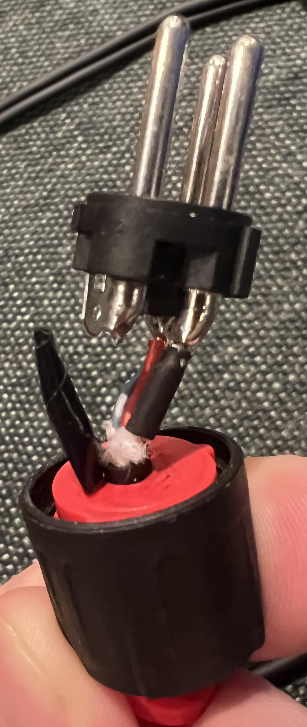

Here is how it looks after I did the adjustments (obviously I closed it up as it was previously before connecting anything to the power amp). Is this correct?
When you say «does it hum with nothing connected to the amp» what exactly do you mean? Do you mean to leave the modifised XLR connector in the power amp, but disconnect the RCA connector from the receiver?

I mean nothing connected to any inputs on the amp. That means nothing plugged into any inputs on the Classe. Your pictures are not clear to me.
Anyhow I told you above the correct wiring arrangement. Live XLR pin 2 and RCA shield pin 3. I don't know how else to explain this.

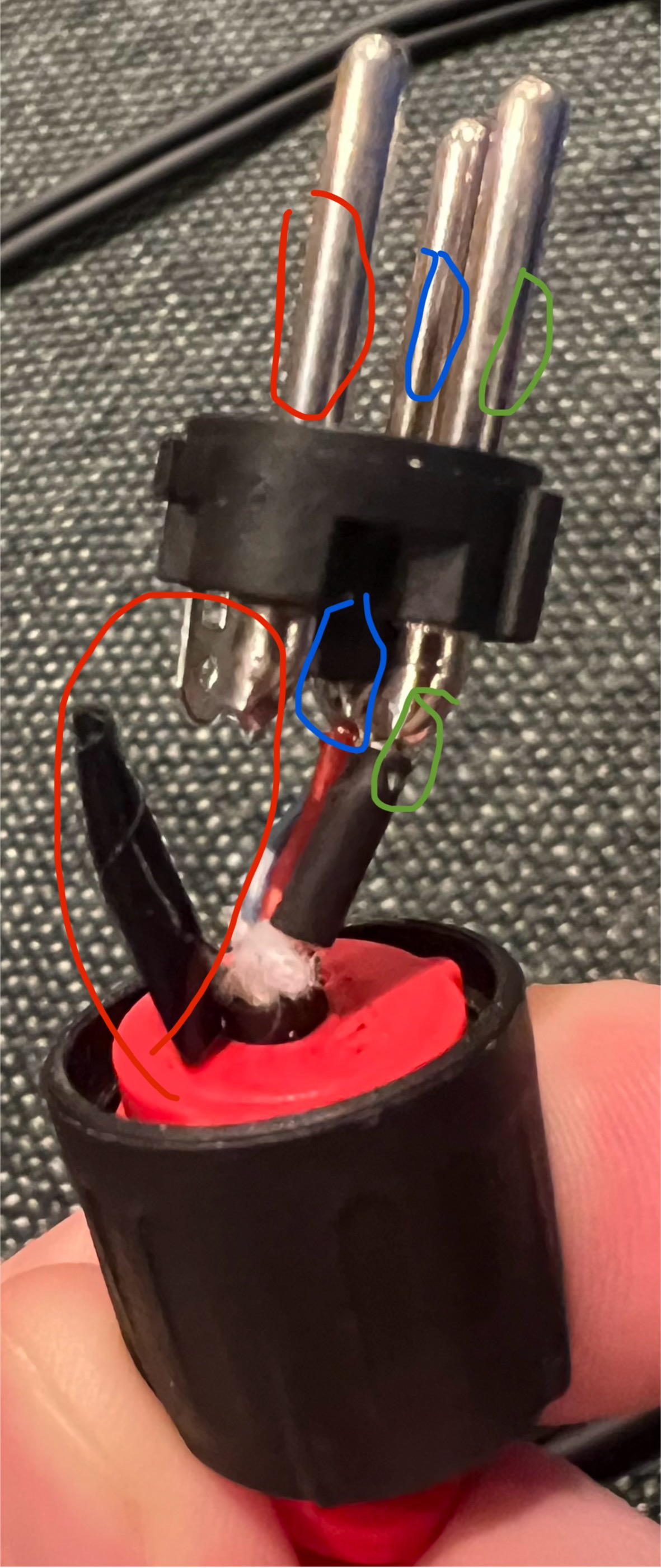

From my understanding then the wire should be correct. Trying to explain the picture in more detail below.
Red rings are Pin1 and the cut wire with electrical tape. Blue rings are the red and blue wires running through the cable soldered to Pin2 (this should be “Live”, right?). Green rings are Pin3 where I assume this would be the RCA shield (not sure how to verify this):

I did not realize that the RCA cable had two wires and a shield. Which wire is connected to the pin of the RCA plug and which the shield. I am assuming red is the pin and black the shield. You need to confirm this with your multimeter. If that is correct you don't need to connect the shield to anything.
You need to confirm that the cable connected to pin 2 is from the RCA pin with your meter and the black is connected to the outer part of the RCA plug. So then it would be red pin 2, black pin 3 and pin 1 not connected.

You mean your circles, not the wires correct? I am summing the red wire with the blue circle is the 'hot' wire from the pin, but you need to confirm that with the meter. You check for continuity on the ohm scale, and continuity would show zero ohms.
So I assume the green circle wire is connected to the collar of the RCA plug. Again you need to confirm this. So that would go to pin 3. If all that is correct then your problem should be solved.
What I meant was that there are two wires going to Pin2, one red and one blue. Not able to take a new picture, but you can see it highlighted here from one of the former pictures:

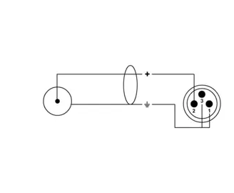

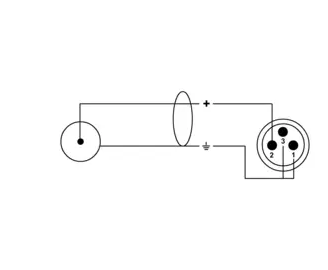

Is your cable connector wired as shown in their website picture below?
If it is, then we are only suggesting you try cutting the connection between pin1 and the shield, or the connector's shell casing if that's how it was soldered to. then it is not the one we previously linked to you as examples.
edit: This cable will not work.

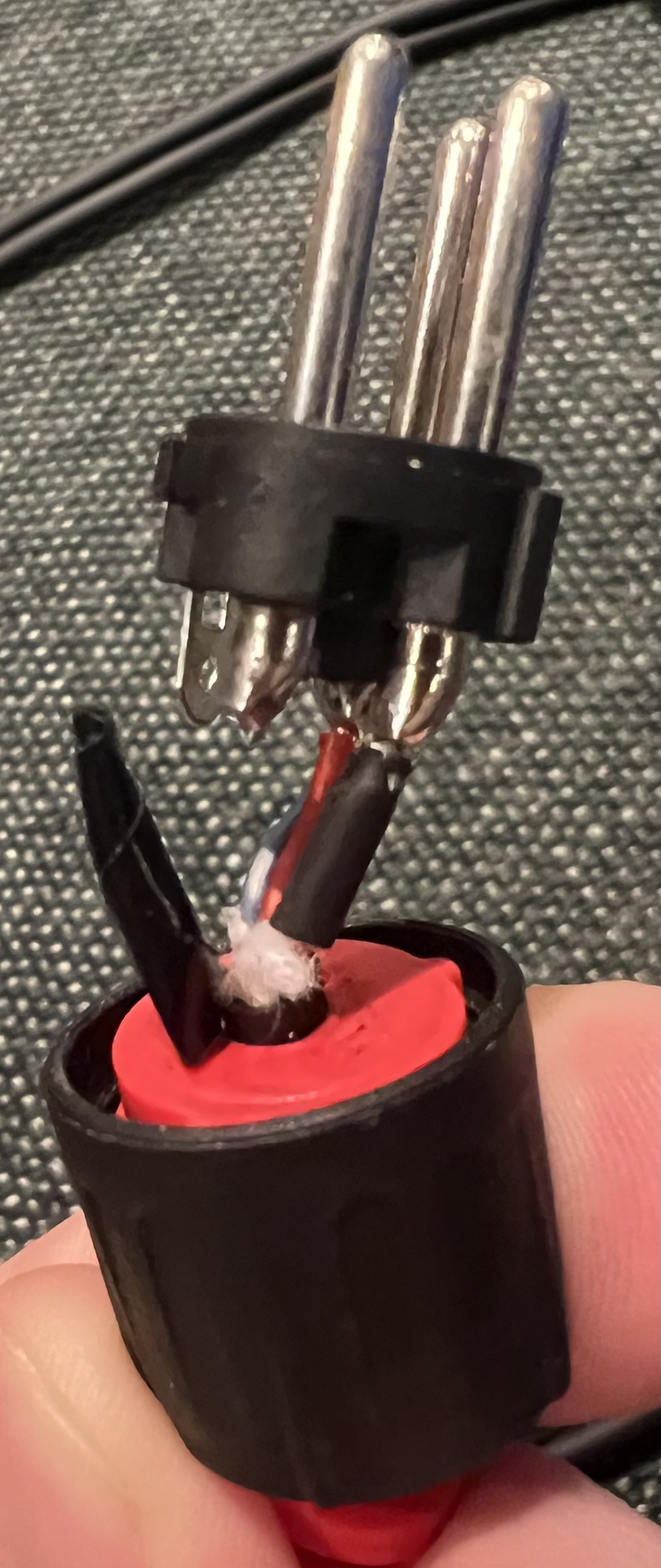

The very slight concern I have, as I explained before is that if on the Denon side, someone the RCA's shield/shell of the connector is not connected to "ground", then you might get "pop" that might be strong enough to damage your speakers. That's why I did not recommend it in the first place, and that's why the better way to combat this issue to wire pin1 to the shell with that resistor and capacitor shown in the Hypex document I linked a couple times before. If you have cut that connection absolutely correctly, when you try again, be sure to be ready to turn power off quickly if you heard any unusual sound, better still, try with just one speaker connector, preferable a cheap speaker, just to make sure there is no pop. The chance of such mishap is slight, but you never know, we are not there to see anything you do.
Not sure if you saw my pictures above to TSL Guy, but I at least only cut the wire to Pin 1 (and put electrical tape over the now exposed wire). The rest I left as it was. However, TSL Guy said this was the incorrect RCA-XLR (that it was a “dual mono cable”). As per my pictures above there are two wires going to Pin2 (red and blue wires), and then one wire was going to Pin1 (which I cut) and one to Pin3.
