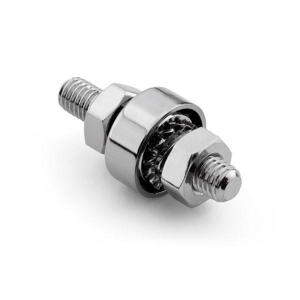

There is a third option: Live with the hum. You could try switching from speaker wire to a ground wire with spade connectors like the ones offered by BJC:
This may provide a more secure connection that will further reduce the level of ground hum, potentially to an acceptable level. Another thing to try, since there is no dedicated lug, is to move the point where the ground wire is connected on the amp. You could even try one of those bolt-on ground lugs:

Thanks for the follow-up. How I have currently connected the speaker wire is through the use of ring terminals that are then mounted behind screws on each of the units.
