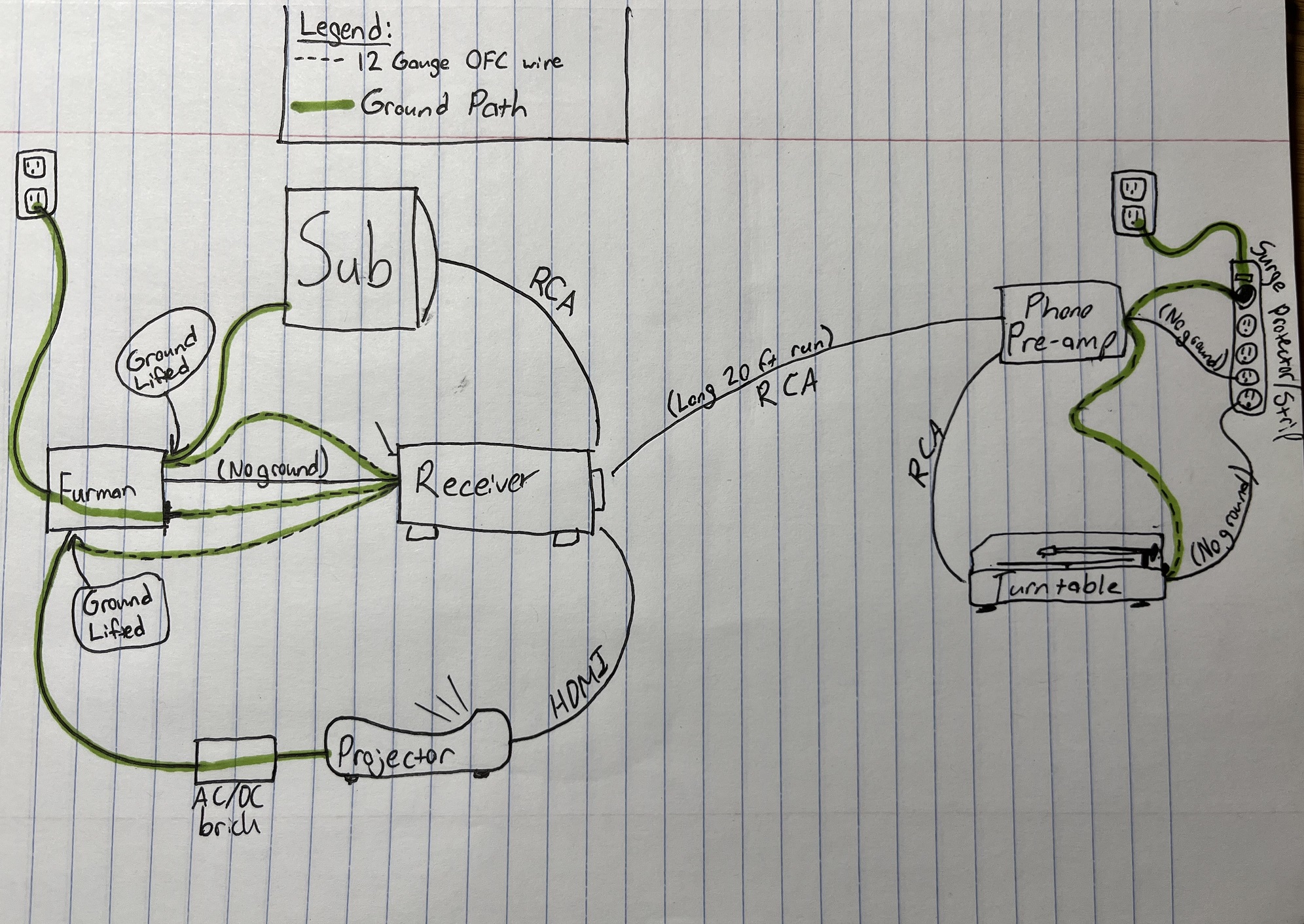

Final update on everything. All is resolved doing what TLS Guy said, with a slight change. Then I added in a turntable setup on the other side of the room. Here's a new diagram of everything.
The one difference is rather than running the 12 gauge ground wire from the AVR all the way back to the wall outlet and screwing it to the screw on the wall plate, I used this product...
https://www.amazon.com/dp/B07Q1DJVNT
...and a banana plug and grounded it to the Furman. I had more trust in a good connection using this than just trying to get it on that screw, and this way I could keep the wiring hidden because that outlet is out in the open and we want this to be attractive, not just functional. I trust the ground wire in the Furman cable to handle the load in a fault scenario, seems thick and it's designed for up to a 15A supply.
On the right I added in the turntable setup with a long run so it needed to be preamplified first rather than using the AVR's preamp. I did not test it without grounding but I wanted to be sure it had the same ground potential as the AVR setup on the left. The shielding on the RCA alone might have done this, but I just wanted to be absolutely sure there was a low resistance path to the same ground on the turntable so I used another one of the above outlet ground adapters to ground it to the power strip. I suppose technically there could be a loop situation here over that long RCA run, but if electricity only wants to take the lowest resistance option it should not be an issue and everything is dead silent.

Well done! The point is that you understood the physics of ground loops. So you followed the physics and were successful. It is my hope you stay on this form and become a problem solver. You were correct to amplify the turntable with that long run.

The Internet cable may still be the problem. Often installers do not install your entry to the home to code. So see if the hum stops after removing all those Ethernet cables. This also applies to any TV cable systems, so disconnect those also.
Just for a test, take out the Furman, and use a power strip. It is just possible it is not a ground loop, but the Furman not able to support the power of the projector, without sending rough power. I personally have a loathing of units like that. There are unnecessary anyway, as the power from the wall does NOT need conditioning. That is absolute bunk. If the hum goes away get rid of it.
If the hum stays then the grounding plan needs changing. The most reliable grounding plan is the "starburst" layout. This is where there is one ground and the other units are grounded back to a central point with stout wire. Remember a ground loop is a resistance between grounds and wires also have resistance.
So, if removing the Furman does not solve the problem, then ground the receiver from the chassis with stout wire via a terminal block at the receiver, and run low resistance grounding wires back to all units to that block.
I have to ground my theater AVP to the metal rack. That is a two prong AC plug. In more complex systems racks are a big advantage and everything bonds to a rack. and then the rack system can be grounded back to the panel. Obviously in most systems that is not possible, but you get the idea.
