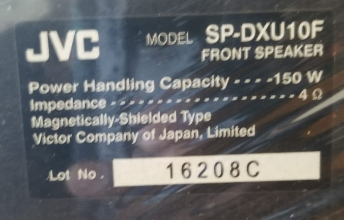

The speakers I've now is from my from age-old HIFI component system,
FRONT SPEAKERS: 150 W per channel, min. RMS, driven into
4 Ohm at I kHz with no more than 10% total
Very soon I am planning to replace that with the tower speakers.
Meant more what make/model of speaker. The wattage rating means little except as a guideline for max power and it sounds more like an amp rating than a speaker rating in this case. Each avr you mention has pre-outs so you can easily add external amplification if needed.

This is what I see on back of the speaker, I would connect to an AVR without using any external amplifiers.
Sometimes an external amp is better with very low impedance speakers, especially if you want to drive them to high levels. If the speaker is rated 4 ohm nominal as this one is, it likely dips to much lower impedance at times.

The main unit stopped working a few years ago so I am not using those speakers now and I thought I could hook up this to a receiver.
JVC DXU10 is the model name.
Yes, you can hook those speakers up to the receivers you mention. Just that if you try very high volume levels it may not work out....
