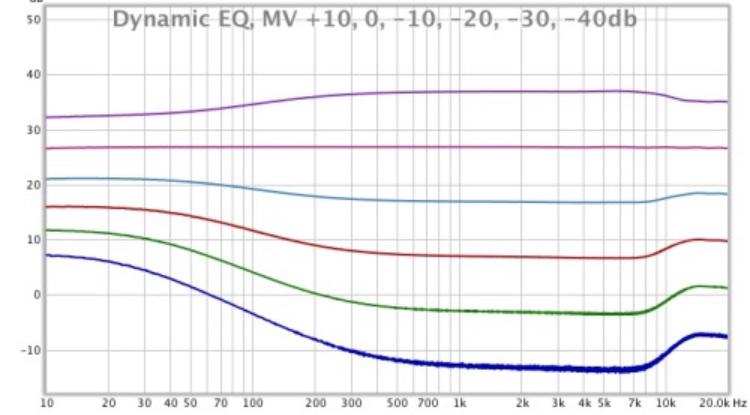

As HD said, Deq is a loudness contour that address how we hear at lower volumes. It’s effects get lessened the closer you get to reference(mv-0). It looks like this.
It mainly focuses on bass, but does boost the treble as well. It also boosts the surround levels, and rear height/too levels too. I don’t use deq as I use a minidsp to set a house curve and I HATE that it boosts surround and rear tops. Ymmv.
I also dislike dynamic volume and have no use or need for it. Tricks? Not necessarily, but they are very powerful.
Hello William, thanks again for posting this graph. I think I asked this question before but forgot the answer, is the above curve you (or someone) saved from the Audyssey website way back before they removed them? I remember saving one like that myself but could never found them in the many hard dives I have had over the years.
Audyssey has done an excellent job removing those curves they definitely published, must have swept cleaned them on the internet too as I couldn't even locate any trace of even cached information.
I just plotted my own the other day, haven't compared them with those shown in your graph yet.
Hi peng!
I saved that graph from another forum where, iirc, the user took the measurements directly from one(or two) of the main preouts.(although it’s probably not impossible that it was the LR speaker terminals)
The idea was to show exactly what deq was doing without the in room FR getting in the way. I didn’t know audyssey actually published their own graphs. That would be fun to see. Also, if you share yours, I’d look forward to that as well.
I always like to share this one because it’s hard to visualize what’s going on with deq and the FR changes vs MV. Most people know that it boosts the bass, but clearly it’s more than that. I’d like to see something referencing what it does to surround and rear top levels vs MV too. I do kinda like the bass curve it applies(don’t use it though) but the surround/too boost is annoying.

Hi peng!

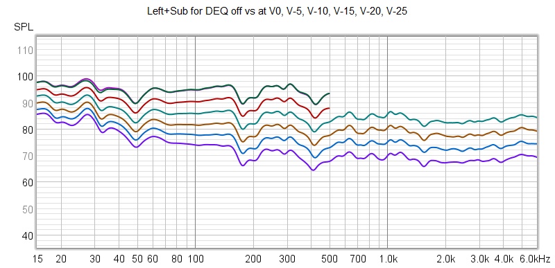

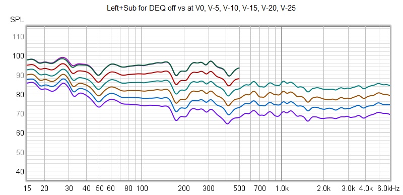

Thanks again, Audyssey definitely published their own FR curves at different MV just too bad I could not find them.
Below are what I have now, taken a few days ago:
The first two curves are DEQ off vs DEQ on but at MV=0, you can see that the bass boosts are virtually 0 as expected.
Nice. Looks like it follows the target as you’d expect. @Pogre did some in room measurements too illustrating deq. I think saved them. I’ll dig around and see!
