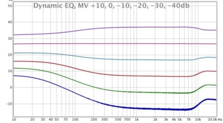

Also, what’s the consensus on Denon processing?
Clearly dynamic EQ and dynamic volume are playing all sorts of tricks. I imagine is an issue of preference… but is there any data on what’s “better”…. These processing tricks, or pure audio calibrated well and listened to on a true red scale (apposed to EQ’d up with audyessey tricks)…
Tricks? Better? They are simply tools you can use, whether you like them or not is up to you. Dynamic EQ is just a loudness contour to "fix" the way we hear certain frequencies at lower than reference volume, and is scaled with the master volume setting. Dynamic Volume is just a compression routine to level out the volume, particularly for playback at lower volumes (like at night to avoid bothering others) by boosting the lower volume content and reducing the higher volume content and evening it out (somewhat like the loudness wars compression). Whether you use them or not is a preference....personally I use DynEQ at lower volumes, but don't use DynamicVol at all....both utilize the basic general eq provided by Audyssey, so it's not opposed but rather in conjunction with.
ps Fixed as had mislabeled Dynamic EQ as Volume.....
As HD said, Deq is a loudness contour that address how we hear at lower volumes. It’s effects get lessened the closer you get to reference(mv-0). It looks like this.
It mainly focuses on bass, but does boost the treble as well. It also boosts the surround levels, and rear height/too levels too. I don’t use deq as I use a minidsp to set a house curve and I HATE that it boosts surround and rear tops. Ymmv.
I also dislike dynamic volume and have no use or need for it. Tricks? Not necessarily, but they are very powerful.
