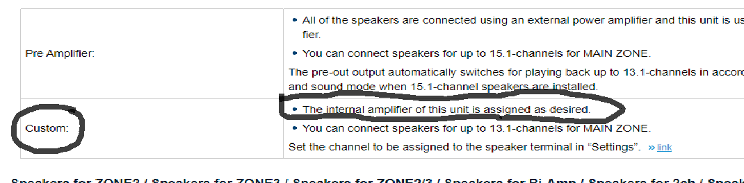

Both are pretty amazing values in my opinion (if one can say that about things costing this much). I would say the x8500 is the better value:
-With custom amp assign, you can disconnect any channel to get max performance with external amps. Being able to use the internal amplification for surrounds while disconnecting R/L/C is really a great feature for those wanting to use external amps on some channels
-Have the extra pair of speaker terminals you can get automatically speaker layouts used for Atmos/Auro3d/DTSx

Wait a minute, so with the 8500 the user can choose to drive the five bed channels with an external amp and 4 four Atmos channels which are driven by the internal amps? The rest of the internal amps can be disconnected?
DJ7675
Yes. To my knowledge it is the only Denon/Marantz that has this feature. With it you can reassign the amp to another use such as zone 2 or zone 3, or it has the option to set it to none.

Yes. To my knowledge it is the only Denon/Marantz that has this feature. With it you can reassign the amp to another use such as zone 2 or zone 3, or it has the option to set it to none.View attachment 36876
Doesn’t custom in this case refer to the main zone and other zones?
I would like to disconnect the LCR, SL and SR because I’m using a dedicated 5-channel power amp. So the 8500 can power the four Atmos channels only. If this is truly possible than the updated 8500 will be my next avr.
I will take some snapshots of the menu which will make it more clear. But with each channel you can control what you want the amp to do. If you set it to another zone, or "none" no output will come out of the speaker terminals, therefore the amp is disconnected. So yes, this feature, if only in the x8500 makes it a tremendous value. Using as many of the amps as you want for surrounds/atmos etc and using external amps with the increase performance of disconnecting the internal amps is what makes it the best value.

Would be hugely appreciated if you can post photos or videos of this feature. I didn't know it was even possible on the 8500, I thought is was all or nothing. Disconnecting amps and select which internal amps should be connected so that the AVR can act as a pure processor is what I'm after.
On my current Marantz 7011 I selected the 11.1 amp assign and selected the mains as pre outs. I also set the back surrounds on "none", because I don't use them. But with the 7011 all internal amps are always connected, no matter the amp assign.
