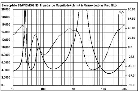

I tried the calc it's good.
The thing is that I don't want to compromise the sound quality due to the weak AVR which can't deliver power to run these speakers properly (without distortion and loud), and shuts down due to overheating.
I know DM can act as a heat radiator when you torture them, that's something I count on ;) just don't want it to shutdown.
I saw some guy who's Marrantz and he was mostly using it on 2chs. In the service they told him that "it's not meant to run on two channels only". I mean OMG!
I like the DM policy where they're using big power supplies, I'm just wondering is that so important to run 5.2.4
Regarding the stereophile measurements, they say the dips are not audible, I've read this.

Correct me if I’m wrong please, but I seem to recall that those particular B&W’s don’t do very good with high volumes. Can’t remember but it seems we had another member who kept blowing his woofers out, and TLS,(and Andrew I thought) kept repeating that they just weren’t high spl friendly.
I think the consensus is that most B&W speakers aren't great. :D
