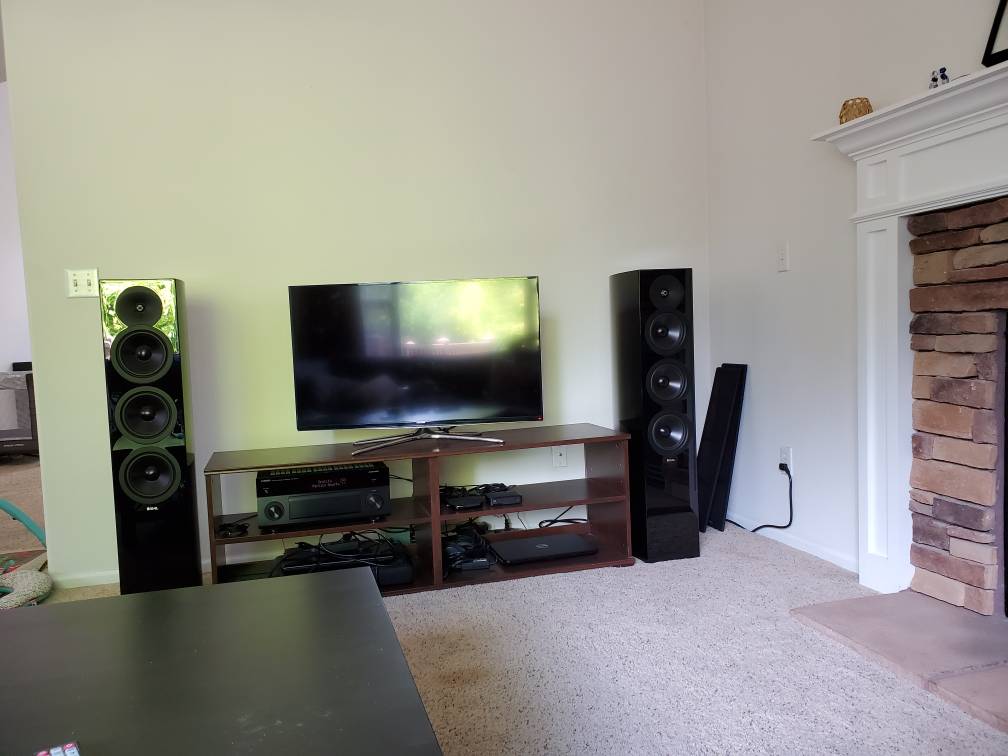

So interestingly, YPAO measured my left speaker as being 10ft away and my right speaker as 9.2ft away. Actual distance of both to the listening position is closer to 9.2ft. Should I adjust the left speaker to also be 9.2ft? Or is YPAO accounting for something in its measurement?
Right speaker is tucked in a corner, left speaker more open. Listening position is dead center between the two speakers.
The YAPO measures differently for the speaker distances as your right speaker is closer to a corner than the left one. My opinion is since the right speaker sits close to a corner, it slightly boosts it's acoustic output and that difference is picked up by the microphone with the resulting distinct distance figure.
I wouldn't change anything in the distance settings. But should you notice that the right speaker is not as loud which I doubt, you could make the adjustment.

Just redid the YPAO, now with speakers facing the listening position and now both were measured at 9.2 ft distance. It did increase the level on the right speaker by +0.5db. Copied over YPAO flat to Manual PEQ and tweaked it so that it's flat from 250hz and up, everything below that I left as measured by YPAO. It essentially boosts the low end on the left speaker, and reduces it on the right speaker, which to me intuitively makes sense as the left is in the open and the right is in a corner. Sounds pretty good at this point, but again I'm sure with rew and some trial and error I can do better :)
Still don't get why YPAO boosts the highs so much, and puts a huge dip in the lower mids.
