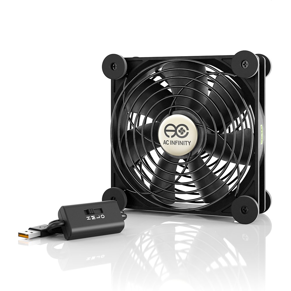

Today I took Peng's suggestion and ordered two:
AC Infinity MULTIFAN S3, Quiet 120mm USB Fan
I was playing my Rock & Roll Hall of fame Blu-Ray close to reference levels the other day, and after an hour I noticed quite an increase in temperature. I figure I might want to keep it cooler to increase it's life. However, I wonder if blowing down or pulling air up would be better. I suspect the latter as the already are 2 fans at the bottom which I assume blow air up and through the chassis.
I have an Infrared Thermo-gun that I'll take some before & after readings to see how well they works.

Amazon Prime is amazing. They came today!

One on top and one at the back (blow horizontally). Both 80 mm, could have use just one 120 mm on. From top of the 4400 to bottom of the shelf, I have only 2.5". With Eco on now, it runs cool, before that it was still touching 40 deg C but that would have been fine too.
I have one 120 mm on top of the MM8003 on low speed but I have 4" of clearance in that compartment.

Thanks Peng. I bought two 120 mm as they weren't much money, and shipped for free. I'm thinking one should suffice.

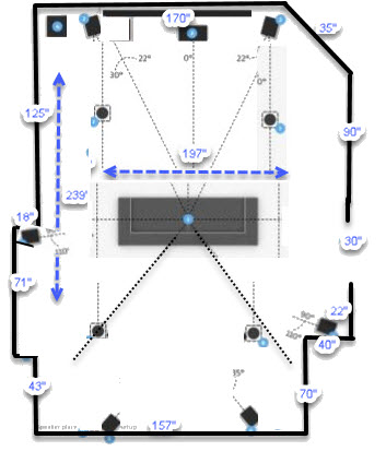

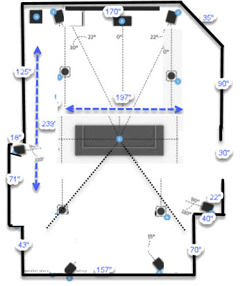

Hi Gents,
I'm posting in a separate thread as I don't want to hijack any others. Hopefully folks here can offer some assistance if I'm going off the rails.
My new Denon AVR-X4400H arrived on the weekend, and I finally got time to begin to set it up in the recently renovated Games Room.
Above is a close representation (not to scale) of the room but a few minor tweaks have occurred since I put the drawing together. The room has a Lazyboy recliner close to the sweet spot, and the only other things in the room are a couple of dozen cardboard boxes still containing mostly kitchen stuff that has yet to find it's "forever home". :rolleyes: The window coverings are "California Shutters", and the floor is a very heavy & wide "tile" strips - like a wide hardwood ( my Misses & her Decorator spec'd it). All I know is the room is very reflective. The TV screen is on the west wall. The jut out on the south wall is a window box and there's a larger window towards the west wall. Above the Sub in the drawing is another window in the corner. I recently added a second Sub, and arbitrarily changed the two Front Speakers to be outboard of the Subs which are now about 20 inches out on either side of the TV. When seated my left ear is pretty much in line with the Left Surround whereas the Right Surround is about 22 inches back (It looks more than that in my drawing because it's not to scale.:oops: ) The toe-ins of the speakers are no where as pronounced as drawn.
As you can tell I was eager to replace my Denon AVR-S900W receiver and try Dolby Atmos / DTS-X /Auro 3D.
So in my haste I followed the quick setup guide, as they don't even supply a paper, or even a CD, Manual on a $2,000 receiver (List price -in Canadian dollars)? OMG! I really should have connected it to our network, and updated the firmware first. Anyway I did the easy setup (with all 8 Audyssey Mic positions) in a pristinely quiet room. I wanted to try an immersive codec so I set it up without the two rear surrounds in this configuration. It ran through the setup routinely and I eagerly stuffed the BluRay Concert on the top of the pile.
