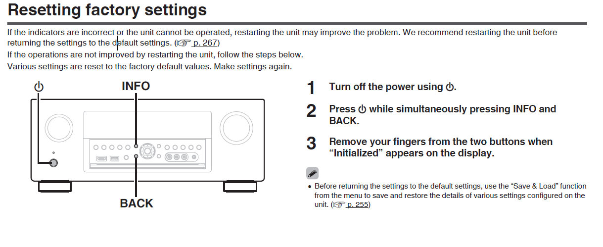

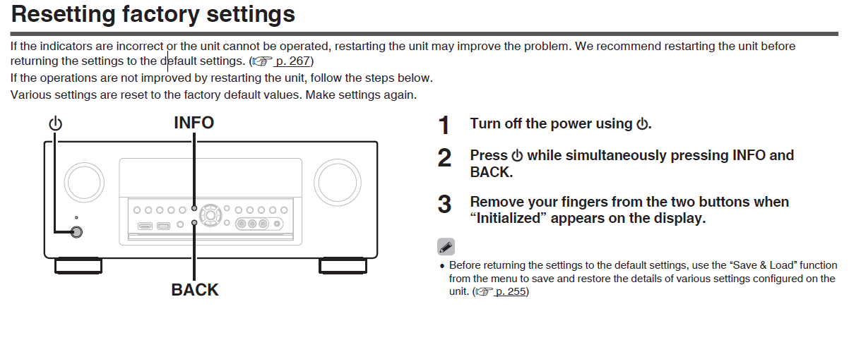

I was wondering what the reset procedure
was for the 4400. So I looked it up.
I'm thinking this may also be a last gasp before calling Denon.

I was wondering what the reset procedure View attachment 24940 was for the 4400. So I looked it up.

2. Re-initializing the processor is a necessary step, because if you call Denon they will ask yo to do it anyway. In fact I thought you had done that already, if not, you should do it first before anything else, it only takes a few seconds.

I did try the reset tonight but no joy. Tomorrow I swap surrounds and then if that fails, I'll call Denon before I put back my "old" Denon AVR-S900W.

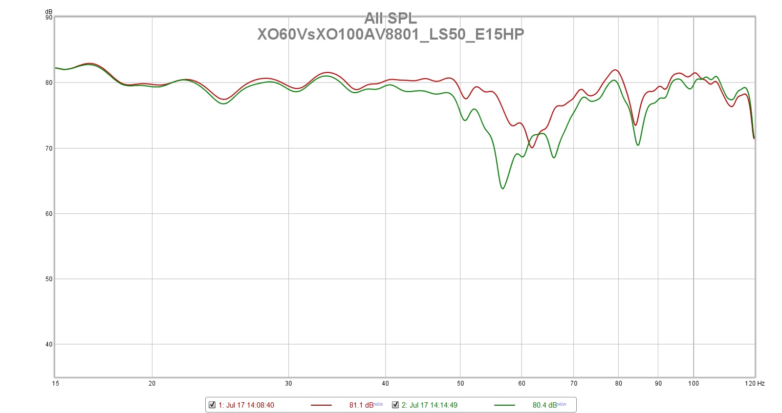

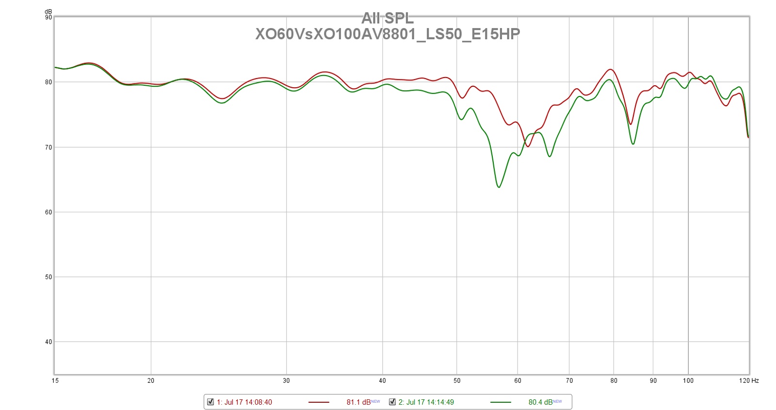

MultEQ does not set crossovers. It simply finds the roll off that each speaker has in the room and where it's placed. The crossovers are set by the AVR maker. There is a benefit in raising the crossover up: the MultEQ filters in the subwoofer channel have 8x more resolution and so will produce a smoother bass response. I would recommend using 80 Hz.
Just to show you the difference I found between XO60 and 90 for my LS50 and E15HP sub, below is a comparison graph, green is 60 Hz, red 100 Hz, with no smoothing at all. That's with the Marantz AV8801, the AVR-X3400H and X4400H actually produced better results for whatever reasons, without even using the App, but I didn't save the 60 Hz plot that I did with the AV8801. Obviously the plots are for both left, right channel and the subwoofer playing together, and it is only in my room for my set up, so ymmv..

The founder Dr. Chris Kyriakakis had clarified this many times in the past.
https://audyssey.zendesk.com/hc/en-...he-cross-over-settings-after-running-Audyssey
Below is pasted from the linked FAQ linked above:

The impact shown in your graph is definitely significant and should be noticeable by ear. Thanks for sharing that. I'd love to have the time to learn REW enough to become proficient, and use it to tweak the system. You seem to have a good handle on it.
