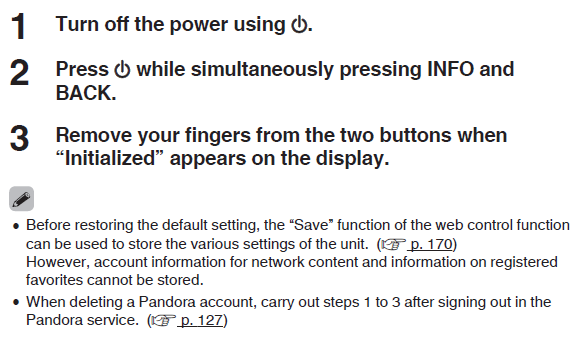

Factory reset procedure:
tried that and never says anything. Initialized never comes up
Make sure you turn off the power using ON/STANDBY on the front panel first,
then press the 3 buttons (per instructions) simultaneously, hold them (all 3) down firmly and don't lift your fingers until "initialized" appears.

Just checking dumb stuff....you are using the panel of the avr for the full reset rather than the remote?
