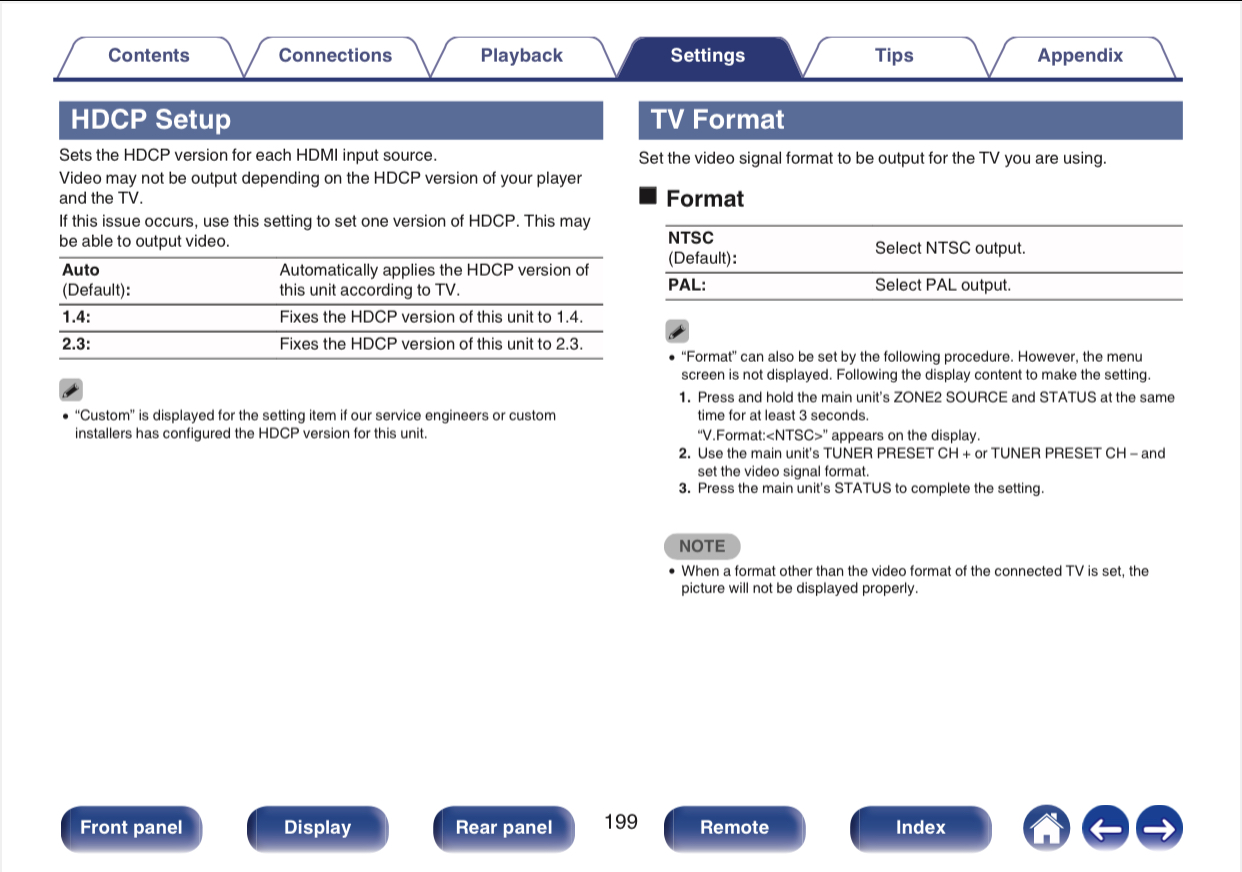

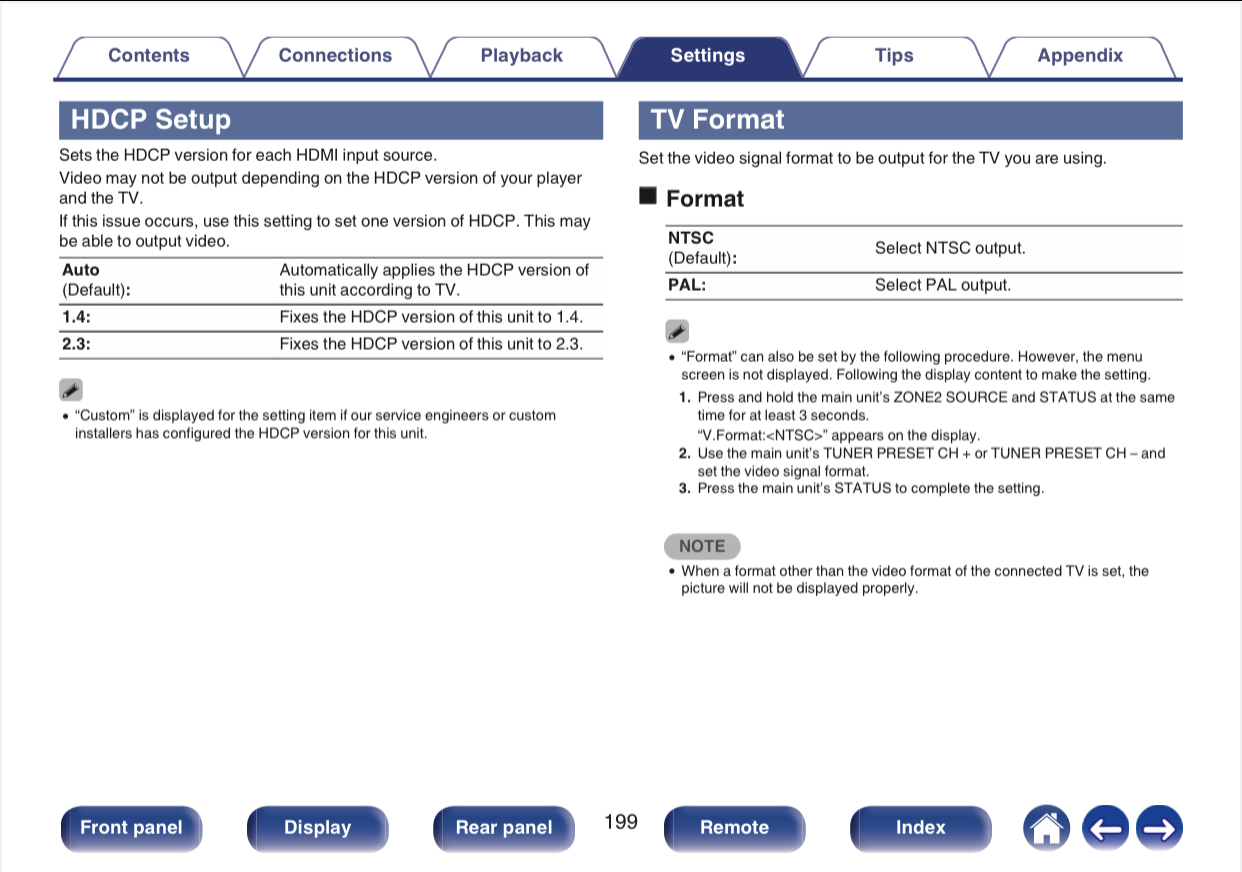

Sorry you are so frustrated. We’ve all been there. Not sure about the version of your Sony, but the Denon is HDCP 2.3 and older HDCP 1.4 devices will have some issues with some new AVRs. The version of the device can be assigned to the input in use. The HDMI Monitor 1and 2 outputs on the Denon do have limited abilities and are not fully independent of each other. The lesser monitor/TV’s resolution will be used.
View attachment 49016View attachment 49017
Thanks for the response.. I have a 4K TV (HDCP 2.2) and have a 4K projector (HDCP 2.3).

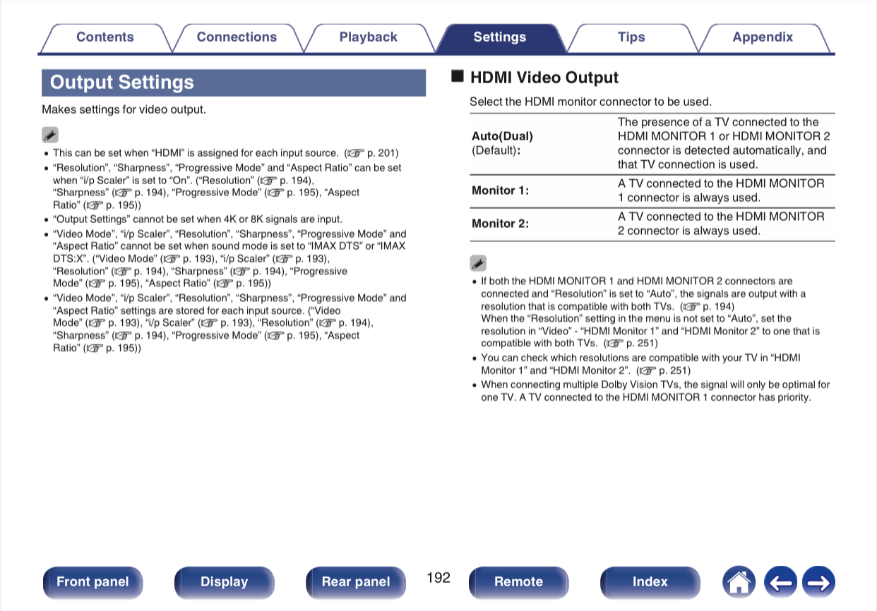

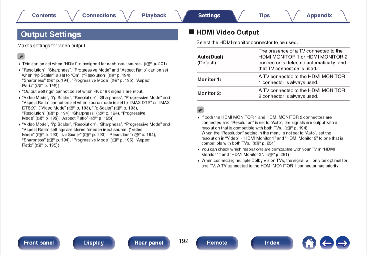

Make all the jokes you want about Sony, but compared to Denon, the quality control is a 99 and the Denon is a 15. I swapped out my Sony for a Denon AVR X3700H for a more premium experience with high end speakers, cables and projector. So what did i end up with.. nothing but problems... how do you fix it? dont use that option, turn this off, turn that off, un plug everything, power it down... reset it.. etc. etc. Yeah it finally worked, but connecting to both a TV and a Projector at the same time is nothing but trouble.. This piece of crap is the worst investment i have ever made with audio equipment. Denon support is non existent, denon sales would rather eat lunch then sell things. Anyone here want a brand new 3 month old Denon? Still under warranty.. give me your best price.. i have all the receipts and bought it from an authorized reseller. I have wasted countless hours.. can someone please recommend a 9.2 4K receiver that will input Directv and Applet TV, and will send video out to my 4K TV and 4K LG Laser projector without me having to go into settings just to watch something, i will buy it, just dont tell me its a Denon.
Hang on, before you shoot it, you may have experienced the exact same problem I had. There's ONE stupid setting (IP SCALER) that you have to get to and force it to NOT mess with your signal all the time. That's where the handshake problems come into play all the time. It glitches out every 5-10 seconds and when you talk to Denon they say all kinds of crazy poop like "make sure you turn the devices on in a specific order" "try using different HDMI ports, ones closest to the projector" n my favourite "Buy a $150 HDMI EDID emulator" which I ALMOST DID...so I agree, the customer support is a bag of rocks.
Here's what I finally found (and am still ticked that they never ever STARTED with this when I called them) that did it for me: in your DENON settings, go to SETUP, then under OUTPUT SETTINGS turn the IP SCALER "OFF". That way the Denon isn't trying to adjust your resolution using it's own scaler. I think the scaler in the Denon is constantly checking the res to see if it's the best, and that makes hiccups with the HDMI handshake all the time.
If all your displays and sources are 4K you can also use the IP SCALER and choose 4K instead of auto, and it should always use a 4K output signal.
Also, in the same OUTPUT SETTINGS right at the top you should have the HDMI VIDEO OUTPUT to AUTO(DUAL)...SHOULD send the same signal out the two outputs you use.
Give that a try and hope it helps.
Thanks for your suggestions.. I did have IP Scaling off and HDMI Video Output to AUTO. I reset everything yesterday and unplugged the units and started from scratch with the TV and it works until i have 2 displays plugged in. Denon told me its bandwidth issues, and so far i have confirmed it.. here is the problem.. it won't work with 8k certified cables both less then 10 ft. I plugged Monitor 2 to a 1080P TV and the other to a 4K TV and still had the problem... independently both outputs work great, full 4K, Dolby Vision. hooking up a 1080p (or anything that or above) to the other HDMI out while the other is connected to a 4K display, the video just stops. Denon says thats by design, too much bandwidth, and splitting causes the issue... so in order to use both outputs simultaneously connected (even though they would never be used at the same time) they recommend HDMI boosters.
