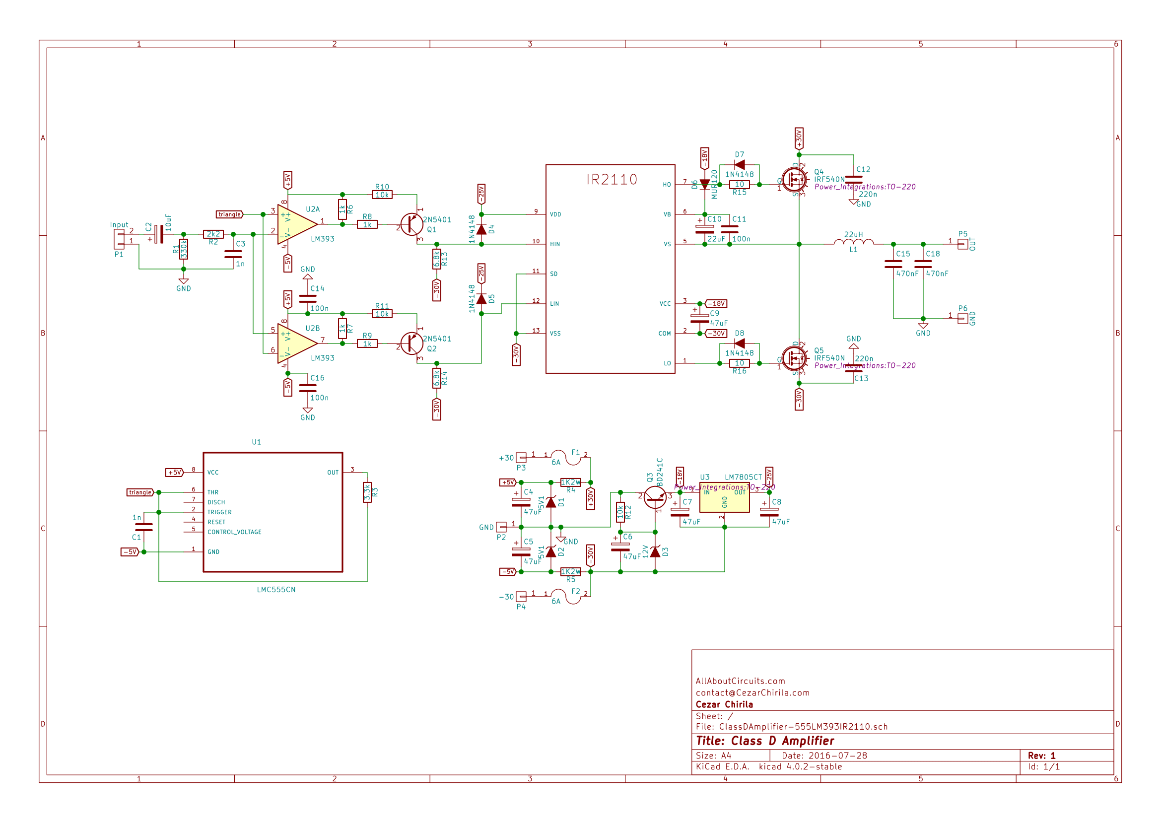

If it was a storm that might do it, but unlikely unless just about everything was toast. Outside of a storm it would be next to impossible for the sub amp to fry an input, as there should be a DC blocking cap on the input, unless it is a rogue design.
Here is a class D amp circuit. To blow up the input a large voltage would have to go back though C3. That would really burn out the sub amp board.
