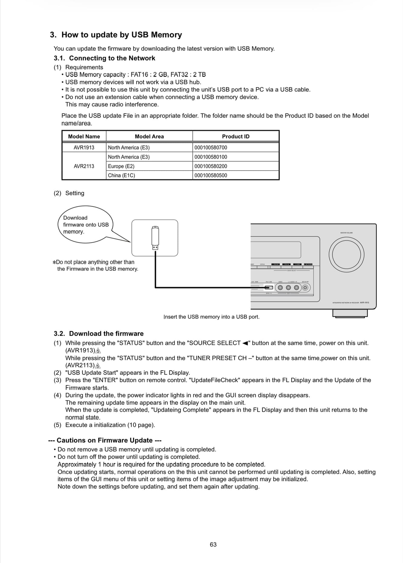

If you look the service manual at p 63 attached below, its possible to update through USB. I understand that the bios has to get flashed and its not rocket science. What I do not get is that I can’t find any firmware file across the web. Beats me :mad:
PS @lovinthehd if you look section 3.1 of page 63 down there, the model in NA is 1913 but its 2113 in EU and china and japan according to denon.jp ;)
