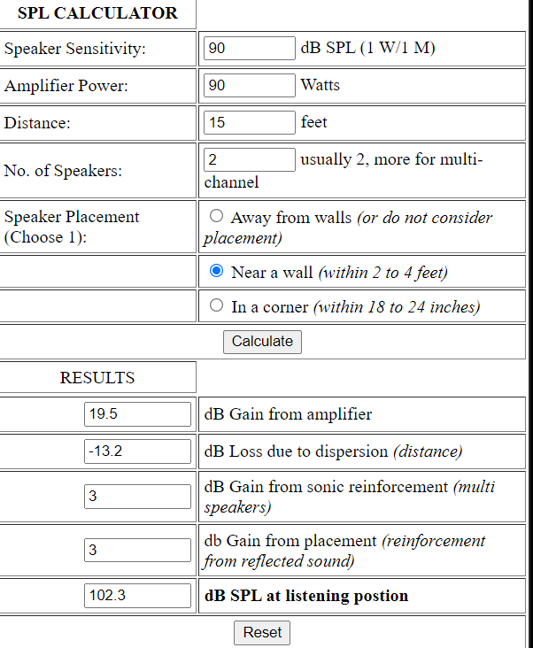

So here's what that calculator gave me. based off my current settings, do you suggest I change anything? My room is about 150sq/ft, not huge.

Looks like you're a bit tapped out at reference levels for movies (0 on the reference scale when calibrated). If you listen that loud. Is it just a 2.1 setup? What are the room dimensions....a room where you're 20ft from the speakers isn't small in my general book :)
