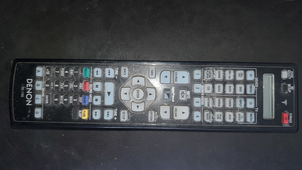

What remote are you using? Please post a photo- it matters.
Use the OEM remote and set it to Zone 2 with an unused source and look at the volume setting- if it's too low, raise it but if it's close to maximum, use the volume control to reduce the setting to -30dB if you're using that scale- if you're using the other, set it to about 20. Then, switch to a source that you DO use and see if it works.
Regardless of whether it works or not, go into the Audio section of the menu and set the volume limit to -15dB for both zones- it will save your speakers at some point.
BTW- if you use the OEM remote- DO NOT press the numeric button that corresponds to the number 1- I did that accidentally when setting up a, AVR-3310CI and the volume went to WOT.

I have attached a photo of the remote.
View attachment 71229If zone 2 amp is blown any thoughts on the cause and process for repair?
