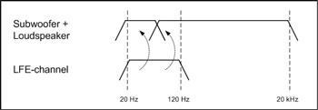

Visual aid...
William Lemmerhirt
William Lemmerhirt
Thank you... was on my phone... hate linking sh!t when I'm on my phone! ;) :cool:
Lol. Me too. What I DO like about Tapatalk is how easy it is to post picks and links. I also have a lot of pics on my phone such as the one above. It’s like 3 button pushes to post one. Niiice!!!
