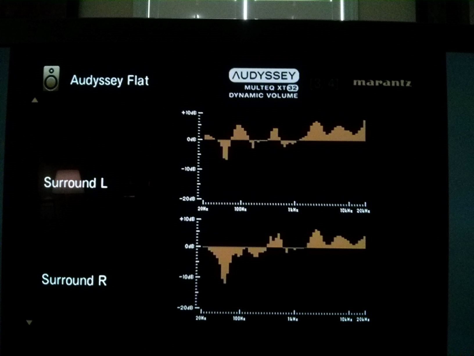

That is a new UI for me. Is that supposed to be what audyssey is doing for room correction? Definitely agree with what Lovin just said... take that with a healthy dose of salt.
Doesn't look new to me, don't you have the same on your SR6012? The 6012 is newer than the X6300H.
I don’t have that on my 6012. Maybe I haven’t pushed all the buttons in my remote yet? Lol
No, the SR6012 does not show that graph at all. In fact, I don't even get cool screenshots of what's on the tv when I enter avr setup. Little jealy. ;)
So the SR6012's don't look like this? May be yours are actually newer.

The way you get in to see those graphs is
Setup--speakers--Audyssey setup--check results--equalizers-- select either reference or flat

Whats the pathway to get to that screen on your menu? I haven't seen anything like that, but I also do not use Dynamic Volume.
Press set up Setup button on the remote and then follow the path:
Speakers/Audyssey Setup/Check Results/Equalizers/Reference (or Flat)
That's how it is for my Denon AVR-X4400H in the HT room, I can try it on the Marantz on my other room but I am quite sure it is exactly the same.
It has nothing to do with Dynamic volume, you don't have to select it to see the equalizers.
It is really not useful, and cannot be trusted too much, it is there just to give people some very rough ideas.
