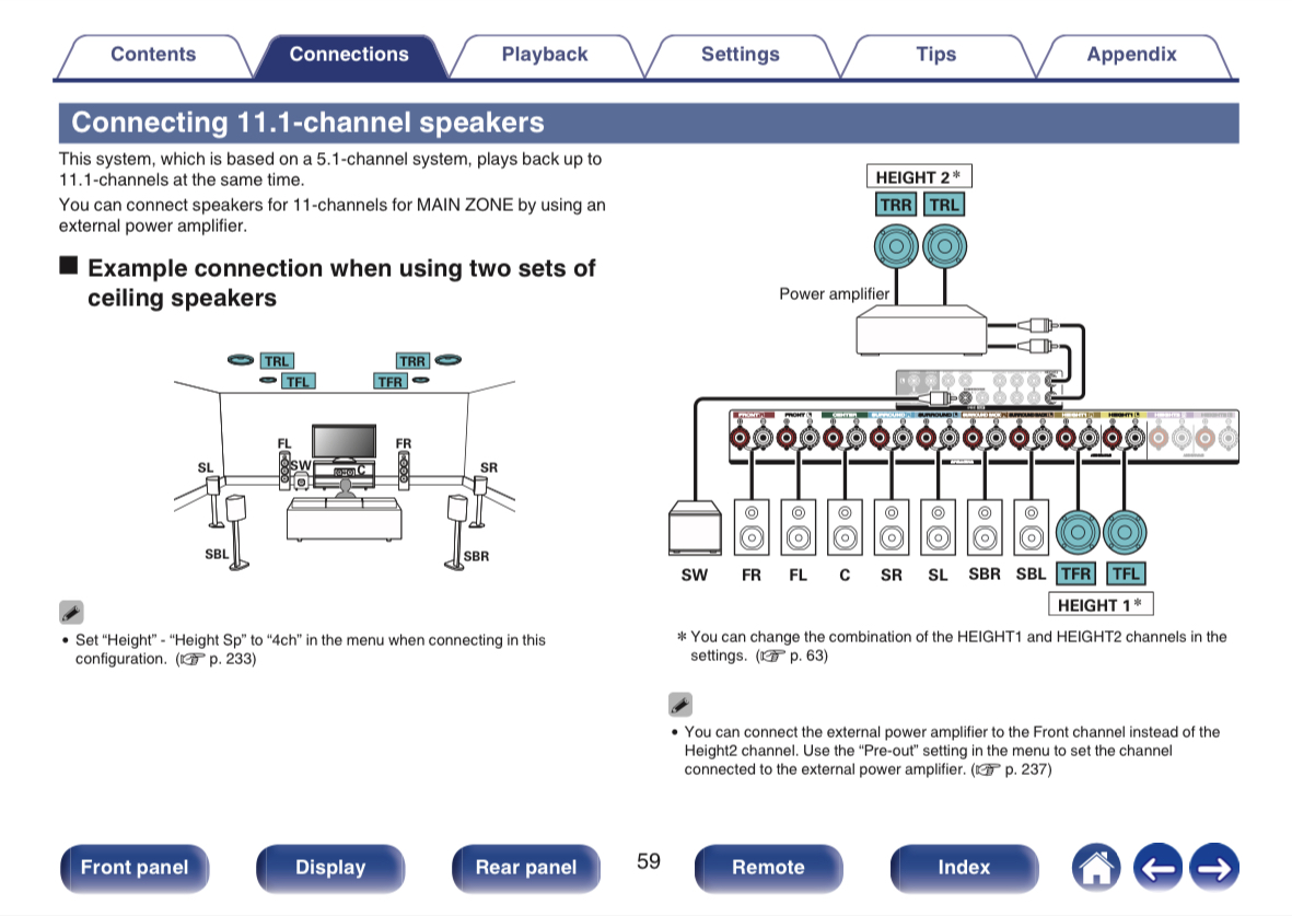

Can you or someone answer this question for me. I’ve gotten conflicting answers. I’m looking to buy the 4700 for a 7.2.4 set up. I want to buy an amp for my fronts and use the 9 amp channels for everything else. I’ve been told that I can’t assign the speakers that way and would still need an external amp for a pair of the height speakers. Essentially, I can’t take the front amp channels and use them for a pair of heights. Even if I have an external for the fronts.

The core five channels are not assignable. You can get an external amp for the fronts but the two internal amps will be left unused as they cannot be reassigned to other channels. So, if processing a 7.2.4 setup, one will need two external amps for the four channels(FL, FR, H2 pair) that will not be powered internally if one is using an external amp for the fronts and wants four height channels as well.

The X6500H will process and power all of the channels in an 11.1(7.1.4) setup. But, like the X4700H, the core five channels cannot be reassigned if one chooses to have an external amp power the front speakers. The X6700H has 13 channels of processing but powers just 11 of them and an external amp would be necessary for the third pair of height speakers or front speakers based on the settings.
Scratch the X4700H as it can do it. The X4500H cannot do so.

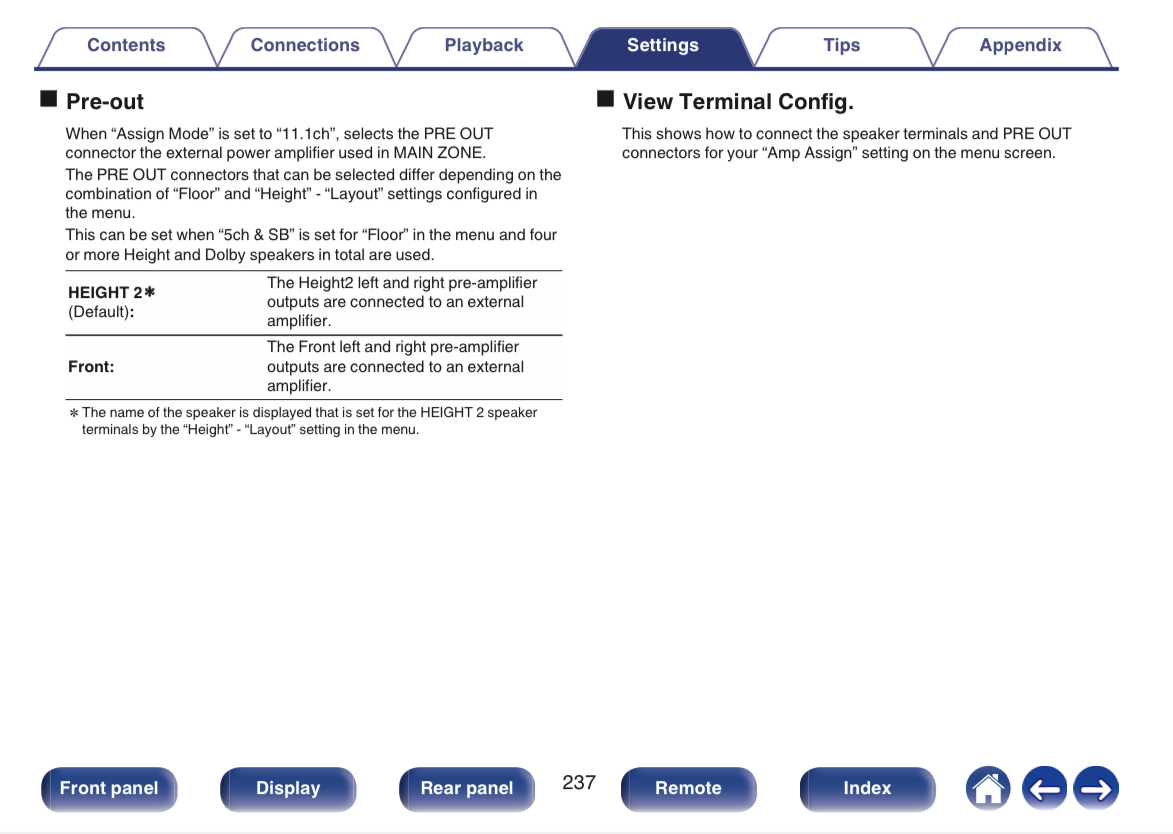

No, you are correct and I need to keep my model numbers straight in my head.o_O I was thinking X4500H models. The Denon X4700H can do the reassignment so that an external amplifier powers the fronts and the rest of the amps are used for the other nine channels. Didn't think a 6012 could do it. Is it perhaps a 6015?;) I will edit my mess above accordingly. My apologies to @Hitchslapped for the misinformation.

That’s outstanding!!!!! I’ll be grabbing the 4700H then!!!!
Denon X4700H:
View attachment 53395View attachment 53396
Just fyi the SR6012 can do that too, just won't benefit as much in terms of THD+N and IMD, likely because the HDAMs add distortions and noise.
