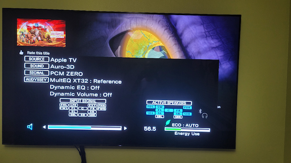

I am settling up the Denon AH4700 with my Sony OLED TV but I can't get all speakers activated, namely the rear surround speakers. I have 4 Dolby atmos speakers (front and surround), two surround speakers, rear speakers, front speakers, a center channel, and two subwoofers. The graphics on the TV shows all my speakers but "Info" on the remote doesn't. The rear surround speakers are missing. I run through all the Amp Assigned on the Denon, but to no avail. How do I solve this issue? I tried to upload a picture of the display but this site said the file is too large.

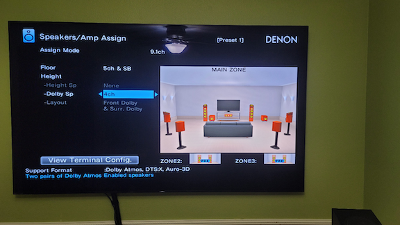

Hello:
I am using the 9.1 configuration on the Denon AH-4700 setup..
Please see the pictures below on how I am setting up but the rear speakers are not showing up.
What do you think?
Hello:
What do you think?
Looks like you're still asking for 5 plus 2 on the floor level plus four in the ceiling for eleven total....so assume it's just eliminating your SB/rear surrounds as you don't have sufficient amp channels....

I think that you have 11 speakers that need power in your room. You can either power the four in-ceiling speakers, or the rear speakers, plus two of the in-ceiling speakers. You've set your receiver up for a 7.1.4 system.
Once again, COUNT the number of speakers you have, then tell us a simple answer of how many need power.
In your receiver's amplifier assign section, you can change what speakers are powered from the receiver.
