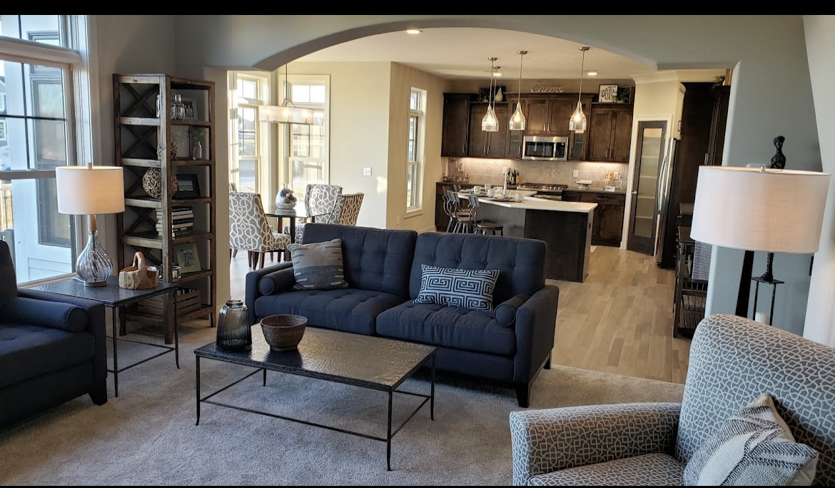

Thanks! Not to hijack this thread…but follow up question there. That room will have obviously only 1 “row” with the row being near the back. Wondering where the 4 would go? 2 fore and 2 aft? The 2 aft atmos speakers would need to go basically right up against the arch separating the rooms. The room will look similar to this (best I could find that looks like it). Wouldn’t theproximity To that boundary create more issues than anything else? Was planning to just have the 2 directly above the couch position.
Sigh. It is obvious from that picture that you did not have grandkids visiting.
Trebdp83
Sigh. It’s obvious you continue to nip at the “egg nog”, what with quoting a post about a room that doesn’t exist yet, for which the poster produced a “for example” pic.That must be a good ol’ family recipe. Now, pass that s#%t over here.;)
