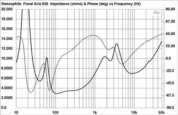

@TLS Guy & @PENG already said it well. Focal Aria 926 speakers do need an external amp to drive them because of their low impedance values.
Like TLS Guy & PENG, I couldn't find an impedance curve for the Focal Aria 926. But I'd like to add two independent and reliable review measurements for the similar but larger Focal Aria 936. One is from SoundStage! and the other is from Stereophile. They look similar to me, and they resemble the impedance curves the others posted above. Focal may make somewhat hard-to-drive speakers, but so do many other companies. At least the various Focal models share a consistent overall design.
Here's the impedance curve of the Focal Aria 936 from Stereophile. It shows frequency vs. ohms (solid black line) as well as the impedance phase curve of impedance phase, frequency vs. phase in degrees (dotted black line).
John Atkinson of Stereophile said this:
I' suggest a relatively inexpensive Class D 2-channel amp from Buckeye Amps. Either one of these:

No wonder the Denon is having trouble. Those Aria speakers are incompetently designed. They claim an impedance of 8 ohm and their spec states the minimum impedance is 2.8 ohms
According to audio review the impedance curve of the 826 is very similar to the 836 and both have similarly low impedance minima.
This is the impedance curve of the 836.
That is a very low impedance across a good deal of the power band and at 80 Hz associated with a very negative phase angle. There are also resonances evident, especially at 80 Hz.
Those speakers will stress any amp and are likely to result in premature failure.
I think a big part the reason is the very low crossover to the mid at 290 Hz.
I can tell you right away, I would never pass a design like that. For me that would be a no build. No doubt about it. So I am not surprised you don't like the sound of the Denon driving those speakers.
So you are going to need an amp of 150 watts with a 2 Ohm rating.
You should consider a speaker change though perhaps rather than an amp. I would not have a speaker like that in my house for five minutes. However luckily I don't buy my speakers, but design and build them. That speaker is not one that I am in the habit of designing.
Speaker manufacturers do tend to lie though their teeth about the impedance of their speakers, and frequently rate them 8 ohm when they are nothing of the sort. In fact the minimum impedance is pretty close to the true impedance. A rule of thumb is minimum impedance plus 10%. So that makes your speaker a 2.9 ohm speaker and not 8.
