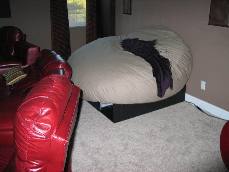

PSA on the bean bag chair, it was an impulse order on one of those discount internet sites and was described as XL with foam chunks instead of beans. I had purchased one before that was the XXL model so was expecting something smaller than the first chair. When I unboxed it, it was vacuum sealed and heavy. Once I broke the seal it was like the clowns piling out of the car. The stinking this is huge!!! Oh well, It’s comfortable and the THSPUD makes it an e-ticket ride.

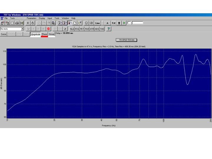

Ivan Beaver from Danley just posted this outdoor measurement of the TH-SPUD this morning.
Here is a measurement OUTDOORS of a single TH SPUD, no crossover filters and no eq. Just TEF machine into amplifier Crown CT1610. 2.83V drive level.

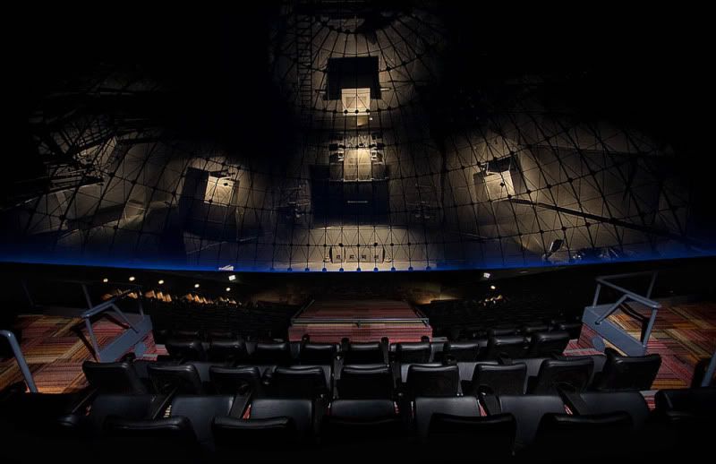

The TH-50’s and SH-96’s look tiny on my computer screen or in a big room like the photo below but much less so in a living room.
