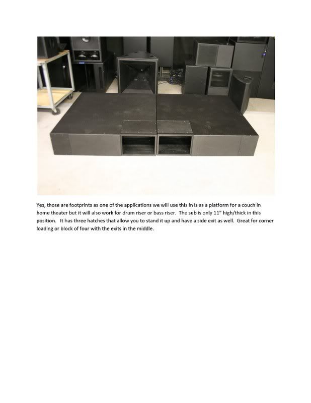

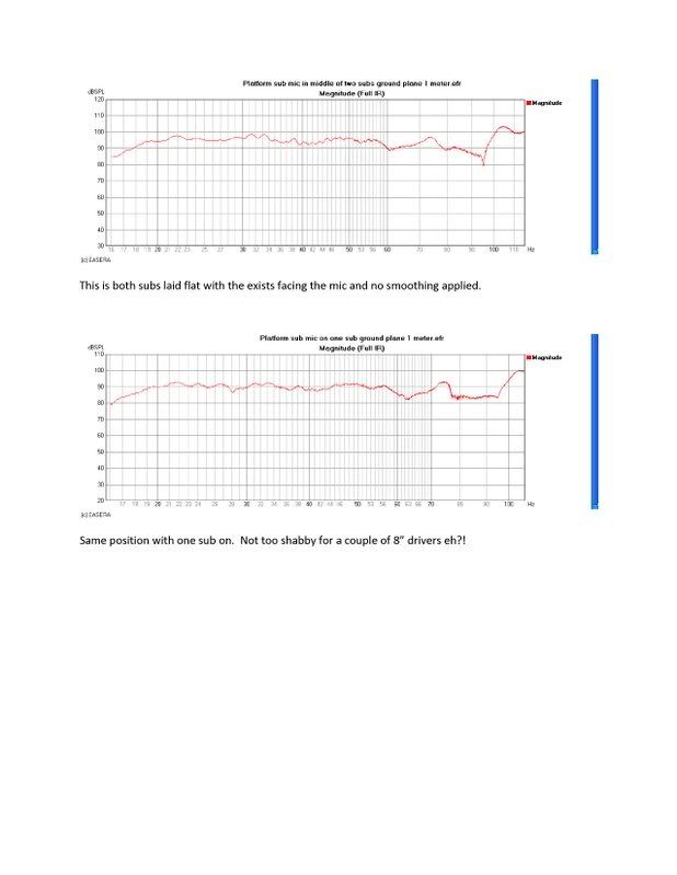

More info from Danley Sound Labs regarding the Couch Sub. This sub was designed to act as a HT riser in the horizontal mode or, vertially it can be placed against a wall. I am going to be using the latter config.
A new approach to the tactile transducer:D:cool:

I'de like to actually see that measured in a useful way such as the HT Shack Sub measurement method plotting actual SPL vs. distortion at a known distance in a free field equivalent environment.
-Chris

Awesome!
