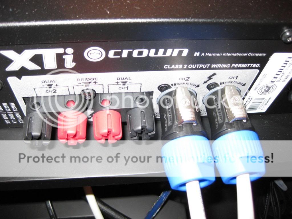

My amp arrived! But, my speakon won't plug into cab anymore. I think when soldering, the tabs maybe bent some from heat, and I'm going to google pics to see if I can get a better idea of how the outside tabs (or all the tabs) look like. I laid the sub down to get a better look, and to make tweaking it easier, but I think I'm at a loss. A rewiring/resoldering could be in order if I don't figure it out. And I just ordered speakons last night, gah, so that would be another shipping charge (and yet more wait time, again).
Sheesh. BTW, is soldering typical or not with the tabs on the interior? And I have to leave soon too, atm.
OH chit, I see I should have bought this kind: (oh great, out of stock at PE until 7/12). edit: ordered the last one from amazon reseller. just in case I can't fix the issue. gah.
and not this kind. Didn't know
This is what i need to look at for a fix:
I can't see the outer left metal tab, but I will have to go with the little I can make out, with the right outer tab (assuming my inner tabs are still fine).

Well, with the long weekend, I am too impatient to wait for the shipments to arrive, so I found a place near me where I can buy the plugs. Unfortunately, they didn't have the screw type, only the tabbed type. I thought they had the screw type initially, because I asked about the female plug specifically, and then I learned that the plate plug is actually called the male. That's just weird and misleading, if you ask me! So, they are called plate plug or cable plug, to avoid confusion, or so I was taught.

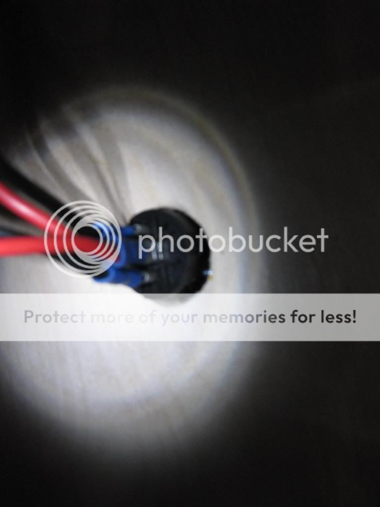

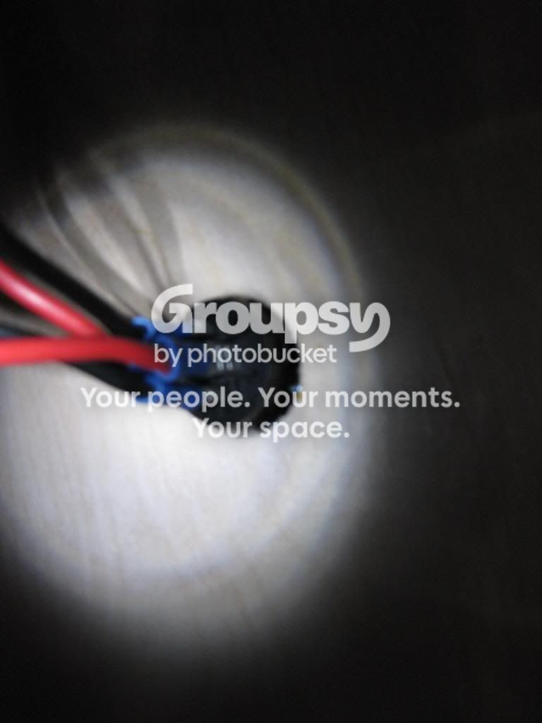

My plate plug is toast. Can't get the tabs to stay at the inner pole. Put new one in, and this time I bought some spades/sleeves (what are they called anyways), and my first crimping tool. The bigger sleeves that can fit my 12 AWG are just too big, where they will touch each other! So, I had to make do with smaller sleeves. I am paranoid of them coming off the tabs, even after crimping, because I have no idea how much pressure/force happens inside, next to the drivers. When the new "screw type" arrives, sigh, to put that on I'll have to remove both hatches again, and man I'm getting sort sick of doing this whole thing.
So, I just got it all back together, will go watch some Stanley Cup and bball, and hopefully read the Crown manual tonight or tomorrow. Take notes of present settings, use RS meter to get sub gain right, defeat Audyssey, and see how it all works out . . .
I bought some "female" plugs to replace the bananas. Interestingly, they only sold the 4 poles, as they said the price difference with the 2 pole is negligible, and it offers more future proofing. I wired them to 1+ and 1-, but what happens if I put them on 2+ and 2-?
And goddammittohell but those 1+/1- things are near impossible to make out, depending on the plug. The new plate plug is MUCH easier to read.
I saw they had enormous 8 pole plugs at the store too. I wonder how big they can get.
The new plug, with crimped wires. Not extremely secure, but relatively secure. Aw man, it's so blurry.

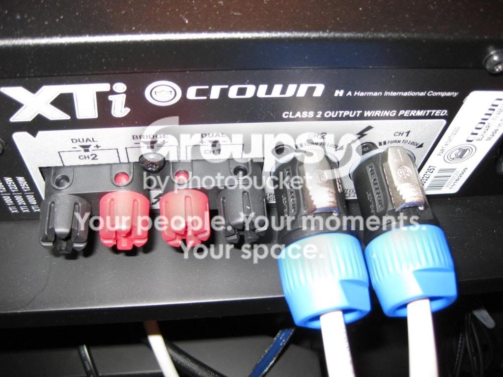

I fired her up, and I have sound. I see that my sub is actually running "cold" compared to my front stage, and left it that way for now.
My amp meters: only the one on the left goes up and down. The right one just stays at minimum, or "ready".
I had the wires with normal polarity, and it appears I wrongly assumed I could just flip one channel out of phase somehow in the menu/setup, but didn't see that, so I rewired the speakon for speaker 1 to be out of phase (if I understood the Danley diagram correctly).
In the menu, it is already set as "stereo", which I presume was the default.
My plate speakon has a bit of rotational give, and I wonder if I did that by trying to get it to work with the busted plug. You know, just trying think of everything, but then it still doesn't make sense that the right meter/amp is not powering/showing anything.
When I set the gain knob on left to zero, and there is no sound. How do I make sure I don't have a faulty amp?
Hm... I guess I can disconnect my front speakers for instance, and just hook those up directly to the amp. In fact, I'm going to cycle the power of the Crown right now.
I wonder if this is user error, or what the heck is going on . . . Got about an hour more of play time, before BBQ time . . .

Ok, I'm a retard, I don't have a y splitter connected. Just using a single XLR, and from previous readings on going mono-bridged, I totally forgot about the stereo thingy.
I don't know if I ever bought a Y splitter! LOL
Samson is still in the box.
Yay, I have an extra XLR male/female, and I used that on the link out of ch 1, to the input of ch2. All is good! (this connection is totally fine, right, no need to buy splitters or anything . . . )
Running various scenes from LOTR right now (since I'm familiar enough to beeline towards certain scenes).
Going to now raise gain knobs to max, and rerun last scene . ..
