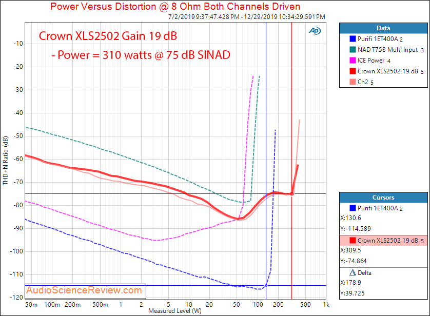

Below is from ASR, for the XLS2502

Nah, I misread the graph and was looking at the 4ohm chart when I mean to check the 8ohm one... (happens when responding at 2am local time...)
Also this power rating as tested was a bit disappointing given the manufacturer spec of 440W (mind you, its not like I am getting anywhere near the "mere" 300W shown here!!!) - but it is also worth keeping in mind that the manufacturer spec is based on the much less demanding 1kHz tone - rather than full range test - so I always think of them as 2/3rds of whatever is on the spec... (which in this case is ample)
And no I have not seen a thorough test done on the earlier XLS2500 that I have - based on the inherent similarities of the designs (and the specifications) - I would assume they are to all intents and purposes identical, or near enough to it.
Effectively this shows that within the important performance area ( roughly 1W to 20W for standard home use!) the THD+N remains below 68db...

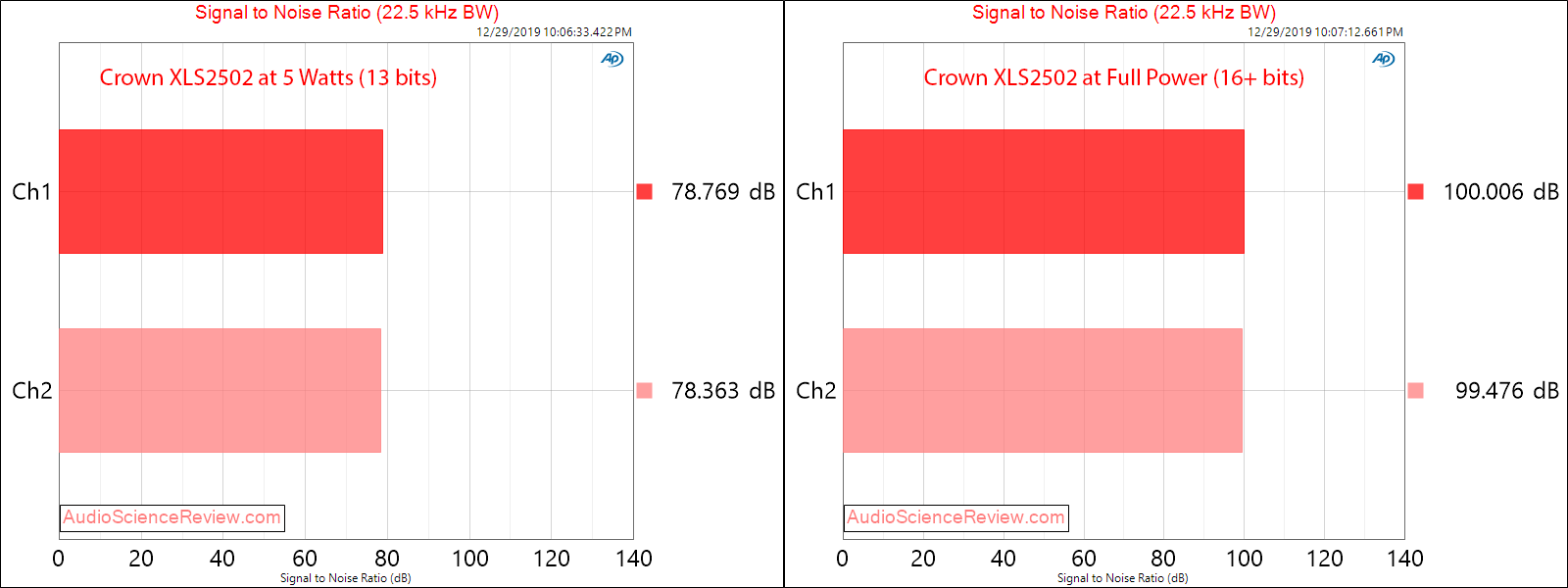

The SNR at 5 Watts (was that 5W into 4 ohm or 8ohm... not clear... but also not the point) - is in the barely acceptable range...
At Full power it is well and truly in the "good" range - but it is never used at that power level.
So yes - in an engineering sense, the specs are less than ideal - but in actual use, for those of us with hard to drive speakers - these amps are absolute lifesavers.
And they leave the vast majority of amps that are within 50% to 100% more than their price, looking (and sounding) pretty sad when it comes to driving such speakers.
