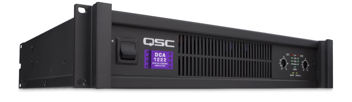

I haven't heard about it but the QSC DCA 1222 which you can get for less has way better specs, with THD of less than 0.03% from 20-20 kHz at full rated output, and IM of less than 0.01% compared to 0.1% and, on top of that it comes with a 3 year warranty. You won't be able to kill it:
