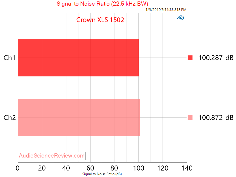

Hello Rich, I don't remember if I responded to this question here, or at ACR before so I may be repeating..
Amir does not always specify the power output level on his chart and in this case he has not. So we can reasonably assume he measured it at rated output of 300 W into 8 ohms, or 5 W per his typical "dash" board setting.
If it was at rated output of 300 W, then SNR of 100 dB, then worse (just my assumption) case scenario based on the same input signal:
SNR is signal to noise ratio so if noise remain the same (again, worse case)then refer to 1 W by calculation:
SNR should drop to approx. 75 dB
If the measured 100 dB was based on his dash board power output level at 5 W, then refer to 1 W by calculation:
SNR should drop to about 86 dB
Formula used:
P2/P1 in dB = Log10(P2/P1), or if you prefer voltage:
V2/V1 in dB = 20*Log10(V2/V1), and you can calculate V2/V1 easily because V2/V1 = SQRT(P2/P1)
P2 is Power output level for the measurement
P1 is Power output level used as reference, so if 1 W is the reference:
P2/P1 = P2, that is, the output level used for the measurement, and
V2/V1 = Square root of P2
75 dB SNR may not be as bad as it looked as Amir did it using 22.5 kHz BW and did not mention what kind, if any, filter was used.
As Gene mentioned before (https://www.audioholics.com/audio-amplifier/basic-amplifier-measurement-techniques)
"We like to see an amplifier be able to deliver at least 80 dB @ 1 watt to ensure it has a low enough noise floor to not mask subtle details of music when listening at low power levels. "
Again, note that on ACR's chart, there was no mentioning of what kind of filter, or none, used.., unless I missed something.
It would be great if everyone clearly state the conditions of their measurements but unfortunately that seems like a very tall order.

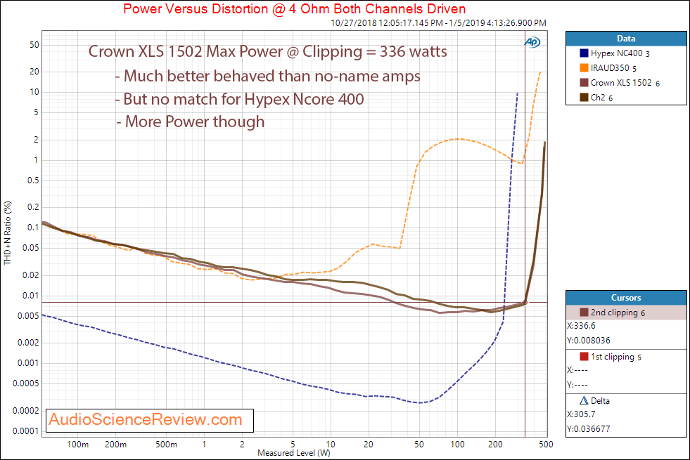

Hi @PENG,
Eye-balling this measurement (8 Ohms is about the same), distortion is about .03 or -70dB down, which is close to your estimate.
If you have a 90 dB efficient speaker, then that is 20 dB of distortion.
Audibility extends below the noise floor of the room. My room at quietest moments is about 40 dB but this noise is not high frequency. It's anecdotal but, you can hear a pin drop. What is the dB of that sound, clearly below the noise floor.
The Audioholics recommendation of THD+N of 80dB is 0.01% at 1 watt. The Crown is not bad.
The issue remains that this is a test signal but driving a resistive load and real loads and signals could be much worse depending on the design.
It a very different amp and a 9x price but this is an interesting set of measurements of the AHB2 by JonMarsh:
It's possible with with more careful approach to lead dress and the test setup, I could have gotten better numbers than this, but let's leave that for the future for now.
One of the things one ought to do to appreciate this amp is compare what it's THD+N figures look like at 100mW compared to may other "high end" amps out there- here, we're coming in at 0.003%, and I've seen many amps for 10X the money coming in at 0.02 to 0.07% at 100mW. For a speaker that's 90 dB efficient, 100mW is a conversational playback level.
By 1W we're down to 0.001% THD+N, and 20W we've reached 0.0003%! Yes, three zeros in front of that 3!
Most of the time, I listen to music at conversational levels for the first watt import to me.
