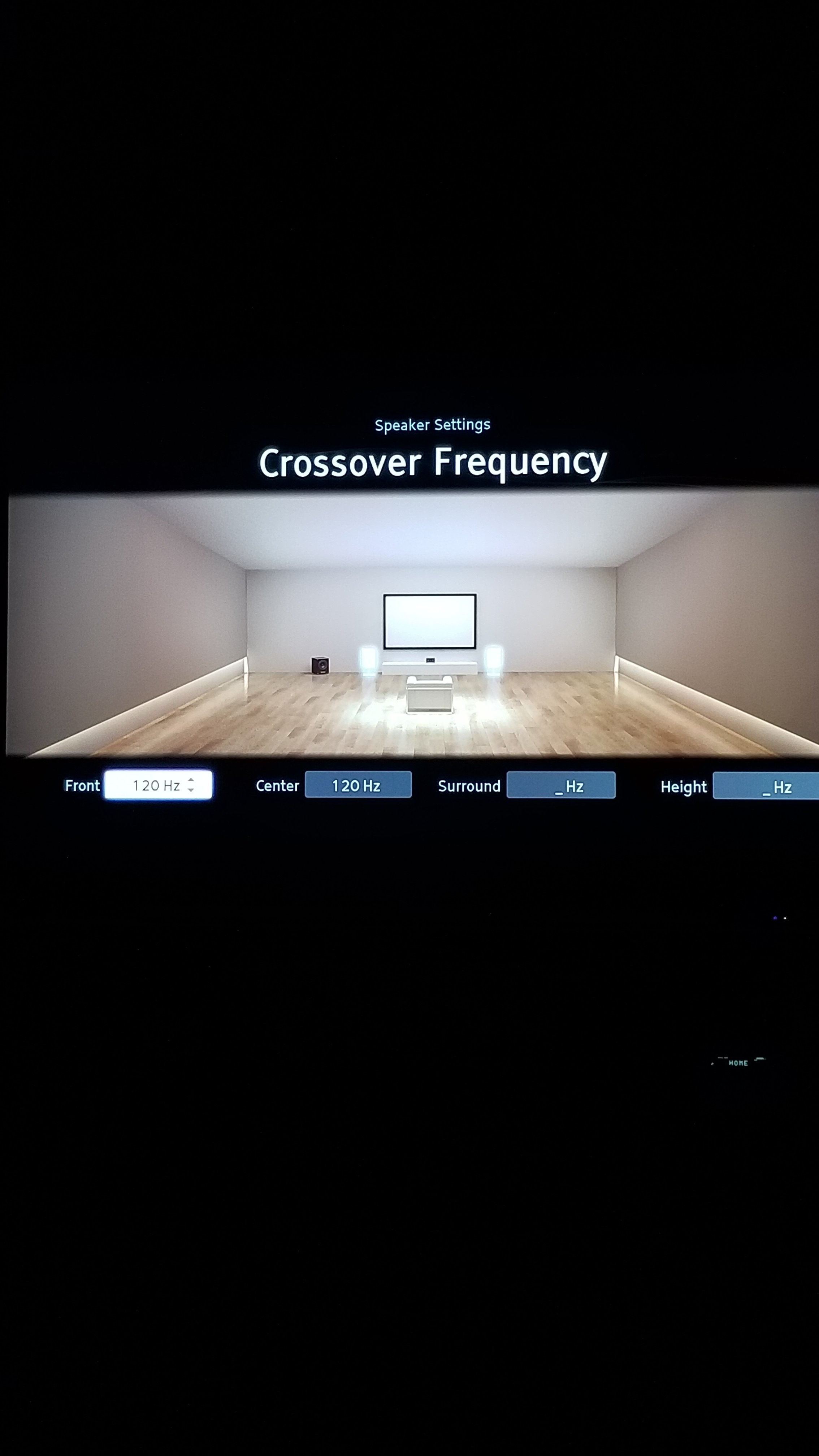

Hey I need some help trying to understand Crossover Frequency and Frequency Response. So the frequency response of my L/R is 44Hz-35000Hz and my Center is 55Hz-35000Hz. The AVR set the crossover to 120Hz(once I changed it from large to small speakers). How is the subwoofer handling 120Hz if my speakers range is 55Hz to 35000Hz? I thought the point of the crossover being set at 120Hz is for the subwoofer to handle what the speakers can't or you don't it to handle?
What avr? If your avr set your speakers to large I don't think it set a crossover of 120hz. Are you looking at the LPF of LFE for the subwoofer? That's not a crossover....just a low pass filter for the LFE channel (when there is ".1" content in a source). The normal setting of the LPF of LFE is 120hz as that is the usual limit of content.
No at large it was set to 80Hz. Here is what I'm looking at.

When an avr sets a speaker to large that means it isn't using bass management, i.e. no crossover. 80 is a generally advised starting point, tho. What make/model of avr is it?

2 ways the subwoofer is handling up to 120hz.
As HD mentioned, the .1 carries info from 3hz up to 120hz. This is encoded into the movie soundtrack. The only thing you can do to this is lower how high the lpf is. For example if localization is a problem with .1 sound effects, you can lower the lpf to help minimize localization.
Secondly, no matter what the FR of your speakers is, if they’re set to small, they will only play what is above the XO point. Everything below is sent to the subwoofer. I’m surprised it set them to 120 considering the f3.
That receiver has a dreadful user manual. No mention of being able to send bass to sub and main speakers. So I assume you can't.
I think the unit has set the crossover wrong. Audyssey did that to me with the center channel. It set the center to small and set the crossover ridiculously high. I showed with measurement that the Baffle Step compensation had to be excessive to not case this to happen. On my front three speakers I can continuously vary the BSC because of the unique design. If BSC was set correctly as precise measurement and listening dictated, then Audyssey made a complete mess of the set up which sounded indescribably bad.
So if some one can figure out how to help the OP, shout. From those awful and highly inadequate manuals I have no idea.

Have you run the auto setup more then the one time? Often a good idea to try again if it gives wonky results. Also run it when its fairly quiet for a good result. You should probably be at about 80-100 crossover for The front 3 speakers.

{Select the size you want. Large: If you connect large speakers that will effectively reproduce bass frequencies, select [Large]. Select [Large] usually. Small: If the sound is distorted, or you hear a lack of surround effects when using multi channel surround sound, select [Small]. You can activate the bass redirection circuitry and output the bass frequencies of each channel from the subwoofer or other [Large] speakers.}
There is no mention of being able to send bass to the sub also, but I would not bet that it does not. The OP can check that by setting the speakers to large as Sony recommends and see if there is output from the sub.
Certainly it looks as if Sony have little confidence in their bass management it seems.
If there is output from the sub with the above recommendation please let us know.
This is possibly not as crazy as it sounds, as I am more and more convinced that keeping capable speakers large and sharing bass duties with the sub is actually the best way to go in most cases. To cross speakers over properly you need to design sub and speakers as a unit to perform optimally in partnership. Design the speakers to properly perform with a crossover that is second order LR high pass and fourth order LR low pass. The vast majority of speakers do not meet that criterion and my recent endeavors tell me that is actually a serious problem.
Sony calls their better manuals "help guides" and the one TLS found on his second try is their best one for this model. This model's help guide isn't all that helpful after a look through it. I also don't find the double bass type setting TLS prefers.
@Noc662 were you using the D.C.A.C. function initially then changing settings manually? Were you using the avr's subwoofer low pass setting? More description on how you're getting to each setting might be interesting but personally I'd simply try setting all speakers to "small" and use an 80hz crossover to start, then experiment above and below that crossover to see if you have a preference. I'd leave the subwoofer low pass filter setting at "off".

Honestly I just did want what I read and seen on YouTube. I set my subwoofer (SVS pb1000) frequency knob to LFE and set the mic for the reveicer to do what it do. I did change the speakers from large to small and the distance of the sub from the listening position....it was a few feet off. I left the levels as is because I wasn't sure about them. But I did feel like if I changed the sub distance I probably should have changed the db of the sub . Like I have said time and time again I'm new to all of this, and just want to get a understanding of what's going on behind the screens.
