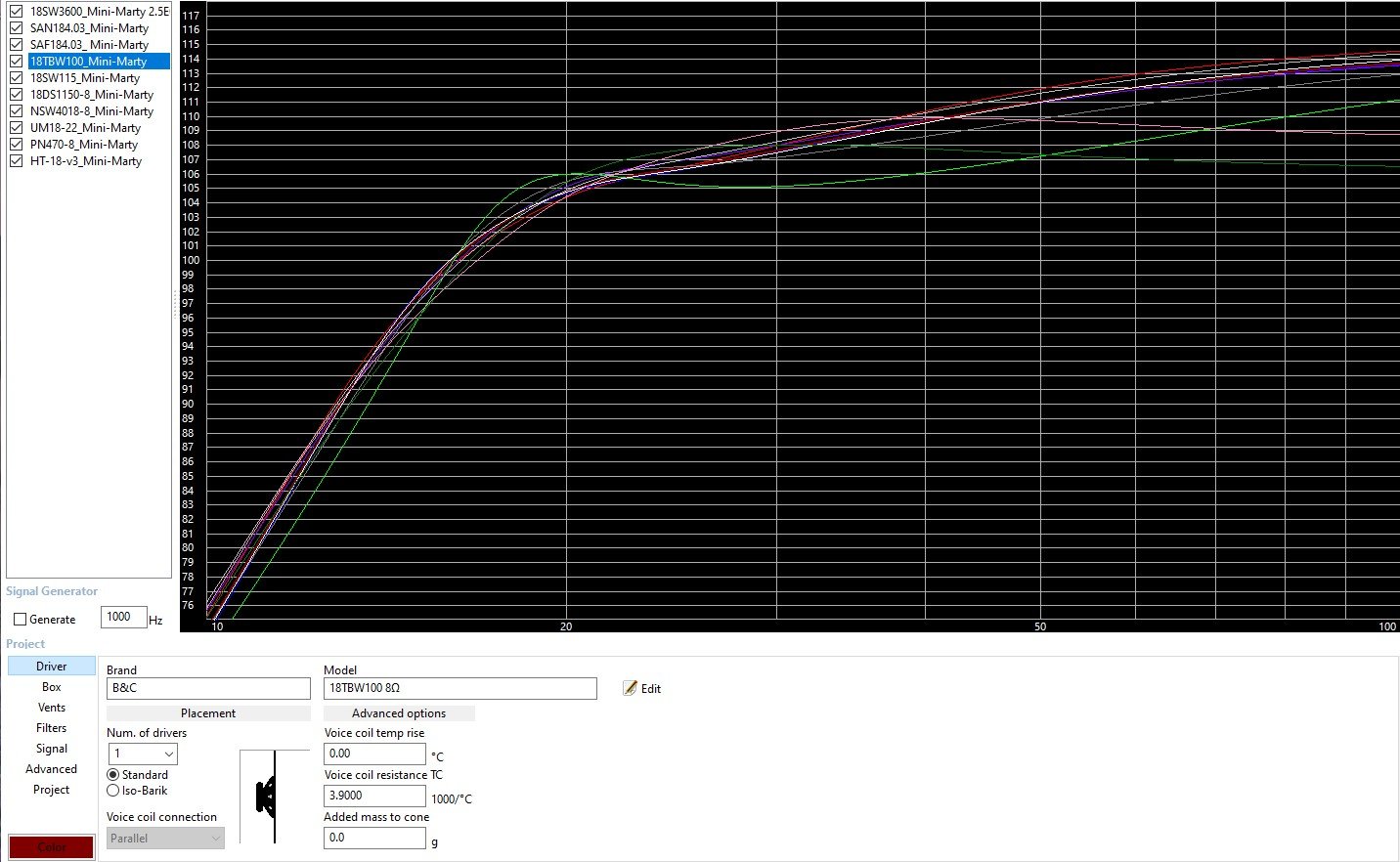

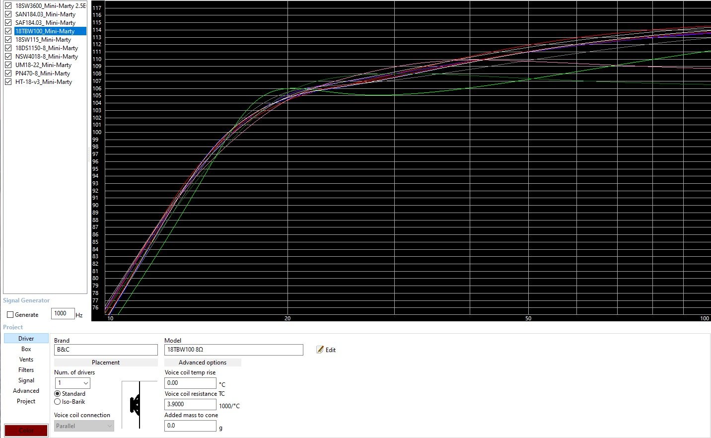

Ah... A man of few words.
So Jason, how much of the behavior here is the Cabinet tune?
Do these models represent any DSP, HPF or a Voltage limit?
Curiosity: the Light Green line with the swale and slightly higher Q peak at 20Hz... which Driver?
Do you happen to have a similar comparison for Full Martys, please?
