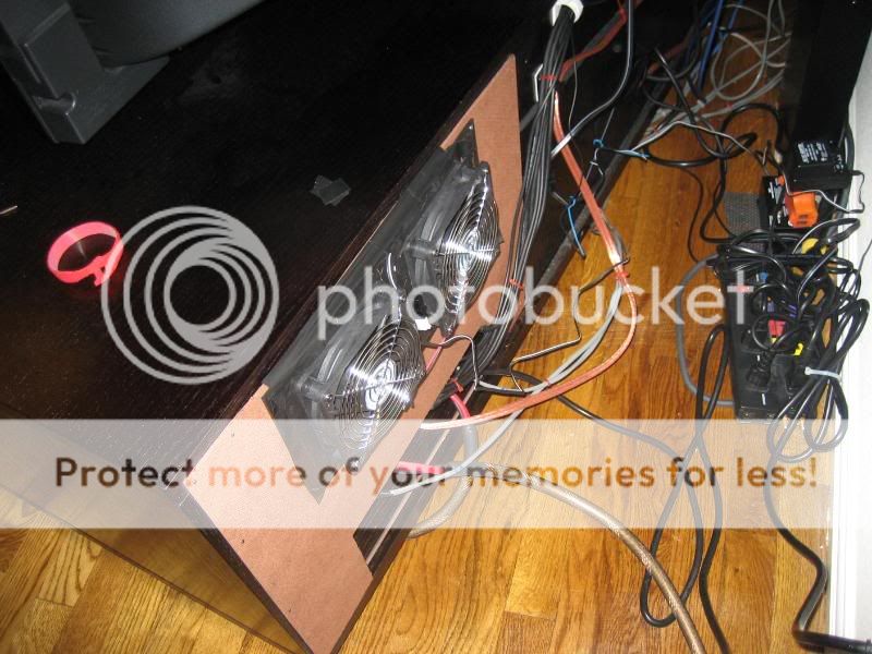

About as generic as they come but works like a charm and can't hear it at all. Never, never, buy this kit....just get 2 fans and save a bundle, that's all I ended up using in the end.
The only other thing you really got out of buying the kit besides the fans was the 120VAC to 12VDC power adapter, which you can probably get at any Radio Shack.
Also, if you ever want to add fans, you can just splice them into the same power lead you have those ones on.
You have some pics of the finished product?
I assume you still have your fingers, because you seem to type fine. :D

Sure I have pictures, it is nothing special but it seems to work well and you can't see it.

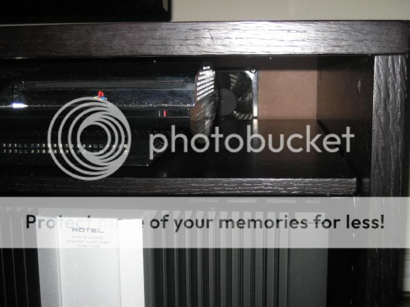

nice job. Those darn PS3's heat up a lot. Mine heats up more than my Amp and Receiver...

So now the question is... how's the temp on the PS3?? :)

Have all my fingers.
Does the PS3 run on medium anymore?
Looks pretty good to me. Not bad for someone who claims to have no handyman skills at all. :D

Yep, my PS3 fan stays on medium which is really loud to me. I have a feeling it won't come on anymore.

Not so far. I struck matches and watched where the smoke went, sucked it in like a champ and spit it out the back.:D

It is plugged into the Xantech AC1 which turns on my sub amp.
So I have the 12v. trigger from my AVR to the Rotel and then out of the Rotel to my SMS. Then I have the 2nd 12v from the AVR to the Xantac which turns on my sub amp and fans.

Now that I have the back nailed on the credenza and the fans mounted, I need to get to the back of my amp. My cables from the AVR are tied up all nice and tight on their way to the amp so it would be a nightmare to disconnect them from the AVR just to move the amp in and out.
Since I am going to have all this out anyway, (painters are coming in to redo the walls so I have to move the whole damn thing) I am wondering if I could redo the mounting system with something that would easily come off and back on. I was thinking maybe doing the back out of a nice plexiglass and using a heavy velcro to mount it. Is there any velcro that is strong enough to hold the back, with mounted fans, to the credenza?
Is there a better way to do this?

Velcro *might* work but I would just put some short screws in place of the nails. Easier to unscrew (provided you have a power-screwer) - the velcro might un-seal your airflow a bit.

If you had velcro all around I think it would hold just fine. They also make different strengths of velcro, so you could get a higher strength one if you were concerned.
Just a note: plexiglass is much, much harder to work with than masonite, in my experience. It loves to crack when you cut it. If you could pry the back off with minimal damage, I would just use velcro on the piece you already made instead...
