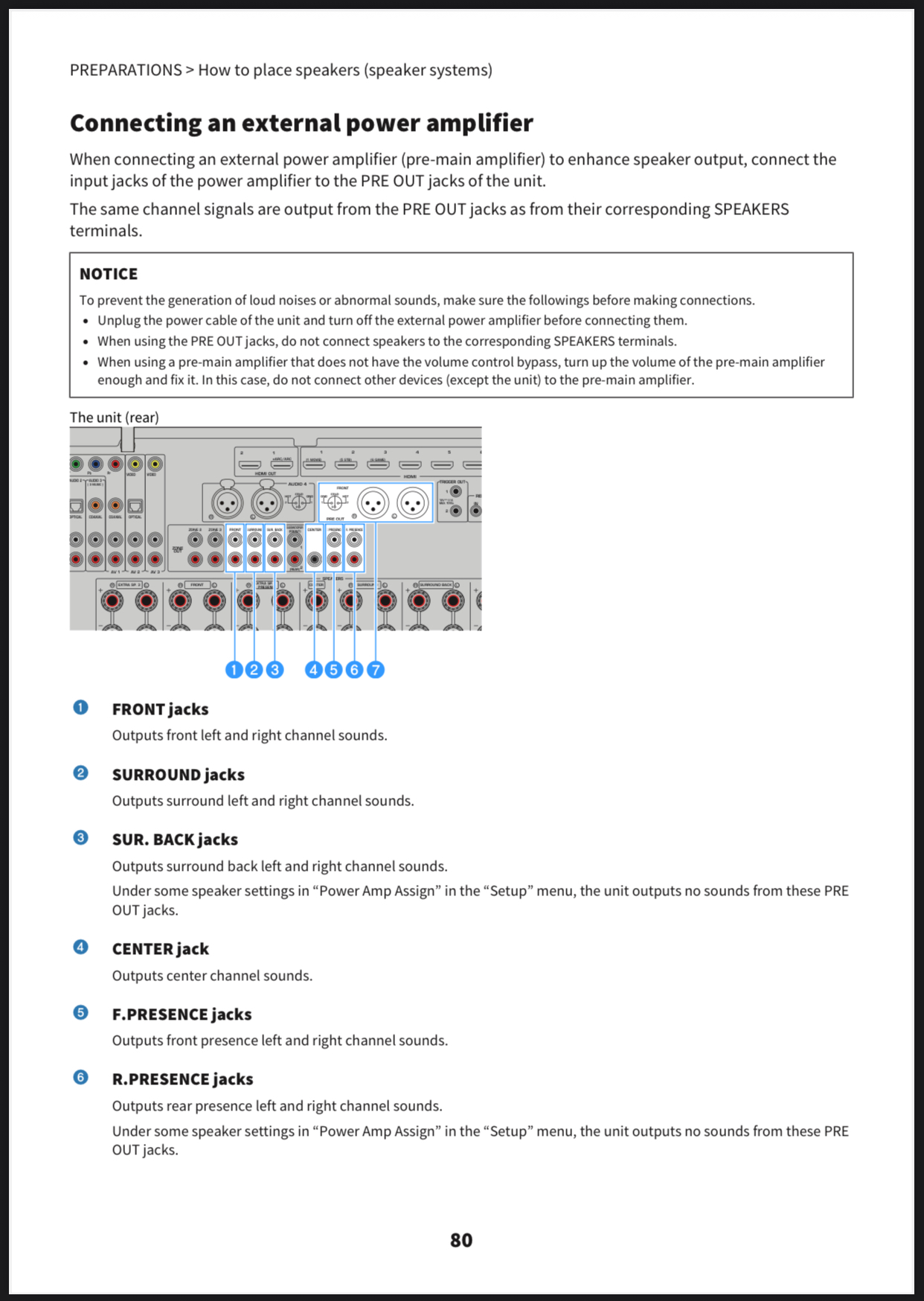

There are both input and output xlr jacks on the A8A receiver, use the ones marked pre-out if using an xlr to xlr cable. Or just use an rca pre-out to xlr input on the amp with an rca to xlr cable.
Tried that. Have got rca/xlr. Could try the xlr/xlr route to see if its those pre outs which are buggy.
Worth checking both pre-outs, but both should be live full time. You already did the reset? Even sometimes a soft reset (unplugging the avr from power for a bit) can clear things up....

As we have told you already, you AVR RX-A8A has XLR for both inputs and outputs, in order to do what you want to do, use a XLR to XLR interconnect cable, connect one end to the XLR outputs (not inputs) at the RX-A8A's XLR pre outs, and the other end to the XLR inputs at the buckeyeamp.
Of course you can also use a RCA to XLR interconnect cable and in that case you already know to connect the RCA end to the RX-A8A's RCA pre outs and the XLR end to the buckeyeamp.
Both ways will work, but the XLR to XLR way is better for the buckeyeamp because the pre out voltage from the AVR's XLR outputs is higher, 2 times higher.
The buckeyeamp is most likely fine, just how you hook things up is likely the issue, but again, it is better to do factory reset on the AVR first and then start from the beginning.
