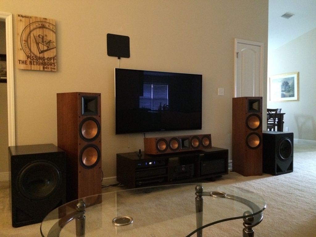

I'll have to do some testing with & without the coffee table, maybe one with a slatted or woven top would help? Maybe we could have an Audioholics test of audiophile quality coffee tables?
Your massive, manly subwoofer certainly has ample output. The advantage of multiple subs isn't just for more output, but it's to smooth out room modes. And hey, maybe you could make a fortune designing a coffee table made out of acoustical treatments!!
Speaking of room treatments, am I correct in that some should go "behind" the front towers? This room is a rectangle and our couch and chair is directly across from the display and speakers, against another wall that looks exactly like the one behind the display. I assumed the panels should go on the wall behind us, but was told they should go behind the fronts first.
That's a very, very nice system. The reason for acoustical treatment behind the speakers is to mostly eliminate the bounce off the wall, which causes sonic anomalies. (Weren't they an '80s band?) The reflection, depending upon frequency, cancels or reinforces the sound. The frequencies subject to this are the hemispherical-radiating ones; from the midrange and down. You could order some color-matched panels from GIK Acoustics and place one behind the left and right speakers. There are other great companies, but I've had good results with them. Nice room!

I you have to use some sort of low table in front of the seats, what would be a good alternative? Is there a type of table or treatment that reduces the reflection? Carpet type surface?
I have two identical sofas in my theater, with the rear one on a riser, and they each seat three people. I have small wooden tables next to the left and right seating positions, with no table in front of the seating. Having a low table in front of you isn't a deal-breaker, but if you listen with and without it, you'll hear a difference in detail. The table slows the arrival times due to the reflection. Reflected and direct sound reach your ears at slightly different times.
Carpet should have a substantial pad, and wool seems to absorb sound better...as well as wine. :rolleyes: There is a "bounce" off the wall behind your LCRs, the wall next to your LCRs, the floor, and, to a lesser extent, the ceiling. The distances from your speakers' woofers (not subwoofer) to the floor, back, and side walls shouldn't all be the same, say two and a half feet. You'll have a peak in your response. If you can randomize these distances a bit, that will smooth out upper bass and lower midrange.

By the way. As to poorly placed speakers? I see many terrific speakers jammed into tiny spaces between TV stands and side walls, backed up tightly against the front wall. Is there a point to paying $2k to $4k for speakers and essentally destroying their capabilities? If the WAF is such that you can't place a speaker to best advantage IMO buy a cheaper speaker! Stuffed in that corner they won't sound any worse. That goes for "bookcase" speakers too! If you can't stand-mount them don't waste your money.
My room (16'X21') is setup mainly for 2-channel audio, although I love a movie with good surround. My main L/R speakers are Martin-Logan Motion 12s (4 ohms) and, after much minute repositioning, they sit out from the long front wall over five feet, spaced at 100 inches. My wife glares at them every time she sits down to watch a movie, expecially since she never gets the money seat (middle seat of three theater recliners). Oh well, she has her play room and I have the media room. She foolishly agreed to that arrangement when we bought the house. Are the speakers out into the room a lot? You bet, and they spread a soundstage across that wall that is broad and tight (those dipole mids, I suppose) with excellent imaging.
I anguished over removing the coffee table but the theater seats (with cup holders and drop-in trays on the arms) solved that. Heavy carpeting and lots of draperies calm the room down nicely. My Denon 3313 AVR does a good job, overall, but I'm looking for a more powerful amp right now. The Denon does strain a bit at higher levels with these 4 ohm speakers. Replace them with a more eficient speaker? Not a chance! Easier and cheaper to add an amp.
My 70" is on the wall with the screen center at about eye level. A good friend thinks it's too low. His? I argued with him for months to NOT mount his over the fireplace. I lost, so let him sit there getting a stiff neck. I sit 10' from the screen and, IMO, that's about right. Most problems I've seen with flat panels are related to poor calibration. Leave the set in it's default setting and get a horribly bright image that will light up your room with unnatural, smeared colors! My friend's reminds me of the displays in Best Buy - bright and gaudy! He loves it so to each his own. If you can't afford a Pro Calibrator (I couldn't) spend some time with video setup!
As for subwoofers? Mine's an Epik 12" sealed design that goes as low as almost anything I can throw at it. I just don't have the need to go lower. It reminds me of Buddy Rich's response when asked why he didn't use two bass drums like Louis Belson. He replied, "Show me something I can't do with one and I'll get a second one."

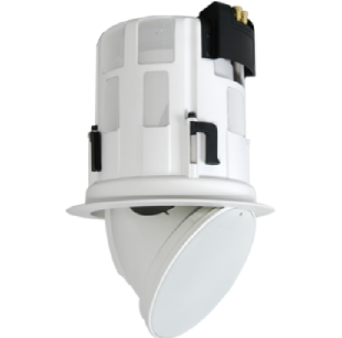

Because of my situation, I have to have in-ceiling speaker BUT I think I passed one mistake in that all 8 speakers aim to where I sit. Plus two of the eight pull down out of the ceiling and turn to exactly where I sit (used as Wides)
