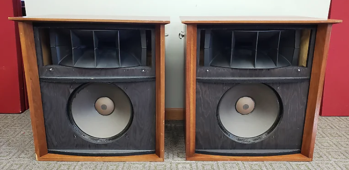

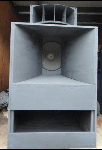

Wish you could come and give a listen. I'm running a very odd setup. I bought a pair of Altec Lansing A7-800 kits back in 1974. They have the 811B horn and cross over at 800 Hz. If you know anything about these vintage speakers, they looked like this.
I don't think there are many people out there still using them for L/R channels. I placed the drivers in the Valencia cabinet of the day. They looked like these. I made my own version with the exact same dimensions.
I had the tweeters redone at Great Plains Audio about 10 years ago. I couldn't find a comparable center channel speaker to match the Altec speaker characteristics, so I built one using a 6 inch Eminence bass driver and an RCF horn. I also designed and built the sub from a 12 inch Lab 12 Eminence driver. Nearfield sweeps on the center channel and sub showed pretty good linearity.
