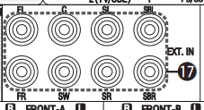

It appears mine does have an Ext In. There is one jack labeled SW. What sort of signal routing are you thinking of here. I'm not familiar with this method.
I assume you mean to run the source signal from my Bell PVR or a DVD player to these inputs? They are currently wired through HDMI.
The question was whether you were already using it. It's more for older disc players where you used the on-board dac of the disc player and exported the sound to the avr to bypass the avr's dac. Not particularly useful overall. Modern Denons have largely done away with this option anyways.
Got it. No, I 've never used those inputs.
I'll definitely try reconfiguring the input levels, as per your idea earlier.
My internet, TV, and phone are sent through Bell Canada's fiber optic network. The audio signals are somewhat compressed but overall, the quality is excellent.
Still, somewhat matters at what level those signals are provided into the avr, but not likely an issue here via hdmi.
