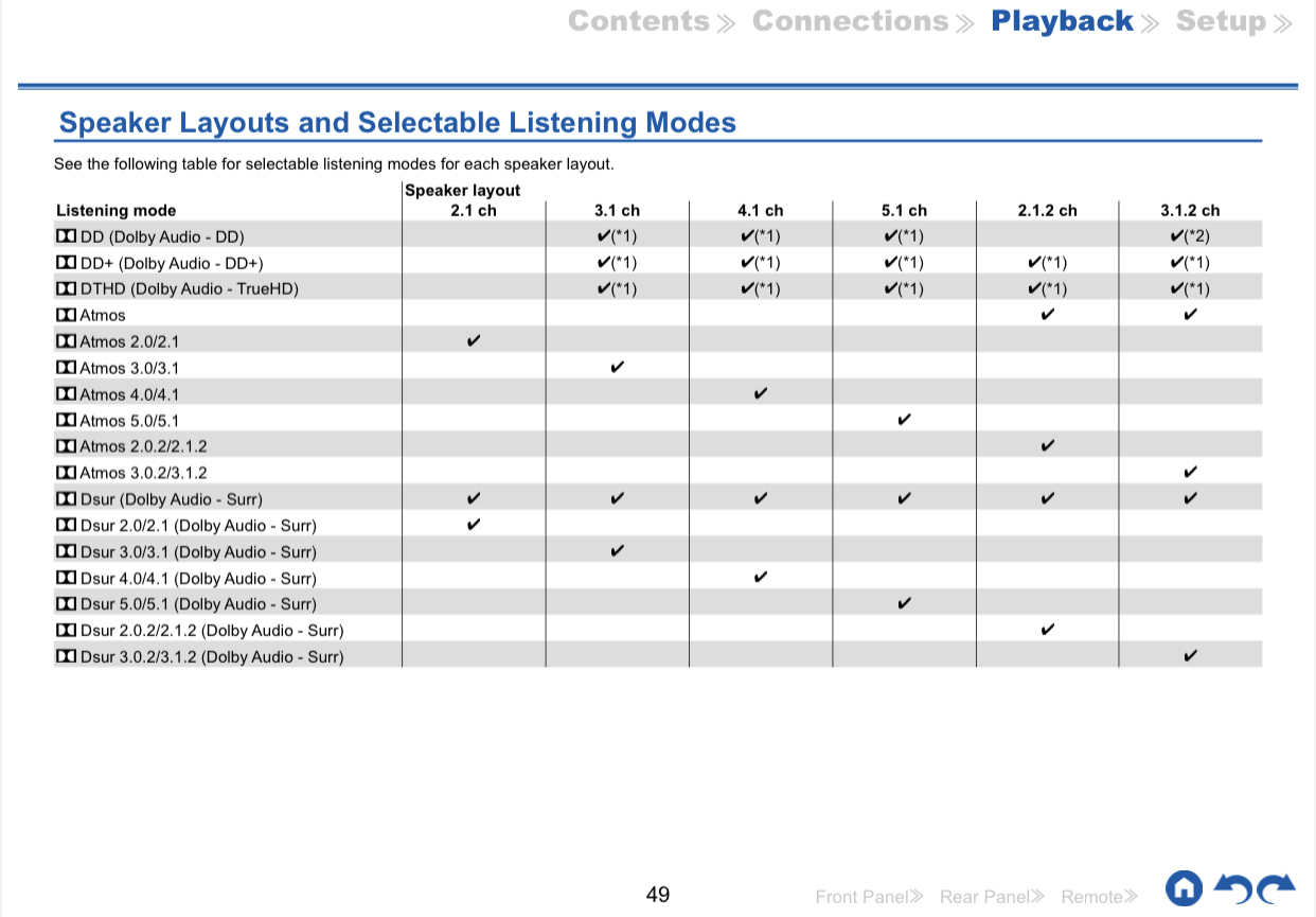

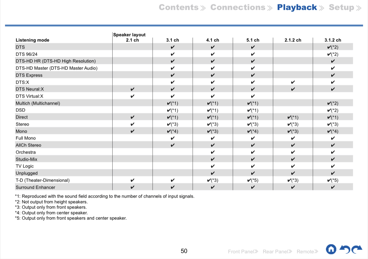

Hello and welcome to the forums. Could you kindly give some information about the TV? As for the clicking of the relays, go into the GUI to the Speaker Setup and make sure you have it set to 2.1 as it could be set to 5.1 or 7.1. This will stop the clicking and you may just want to set it to stereo mode for each input as your options are limited when set for 2.1 and even more still depending on the audio codec in play.

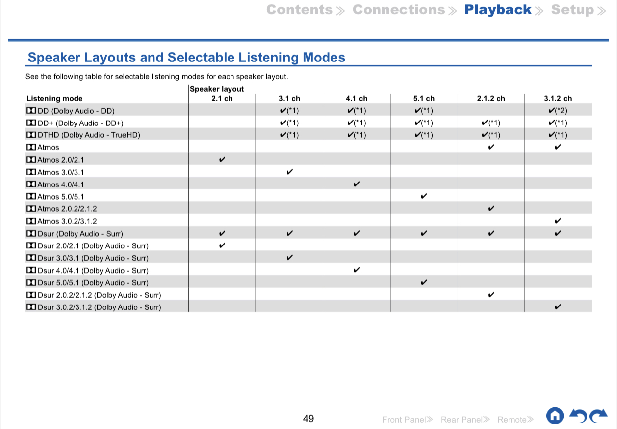

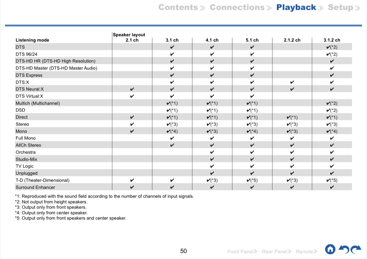

ANSWER: Circa 2013 Panasonic plasma with "arc" the AV unit is an ONKYO TX-NR626 - everything worked reasonably well for the last 8 years. The only change, is the new NVidia remote for my Shield box, the little flat jobber remote died. Although it's possible that the new NVidia remote and the CEC setting is not the cause and it's a coincidence, the only other conceivable possibility is that the Onkyo is dying. Hence my questions regarding Yamaha. BTW, I used to have a JVC AV unit with S video and a Toshiba TV the same thing happened to the JVC with the sound, clicking and everything - I always suspected it was a power surge. The local cable company narrative is that they ping their boxes and if there's no return the box won't work correctly so they have a person invade your house and disconnect the surge protector. If you connect it again certain channels don't work I only use it for football so those are the channels that won't work. Everyone I tell this too thinks I'm crazy, which is true by the fact that I continue to live in the USA.

My apologies for referencing a 393 manual. Not sure where I came up with that one but it wouldn’t be the first time I mixed up a couple of different threads. So, is there a reason you prefer the Nvidia Shield connected directly to the TV? You mentioned ARC. You can eliminate some headaches by connecting it directly to the Onkyo and turning HDMI-CEC and ARC off. The TV can be just a monitor unless you need ARC for another reason.
