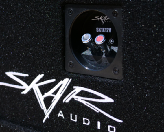

For spring terminals, you would use a banana plug with a flex pin that can go in there. It is FAR more common to use bare wire, but if you are going to use a banana plug, you will want one with a flex pin that can go inside that spring terminal.

Hi guys what type of terminals can I use for these connectors? I don't want to use the bare twisted wire:
Why don't you want to use bare wire? It's the most direct connection without having an unbroken run from amp to speaker.
You could use this with banana plugs but that means that you will have added three points connection to the signal path and, therefore, another three potential points of failure.

I just wanted something fancy, I hate when you twist the wires and some don't go in completely, but I think I will go with bare wire just for this case, I used banana plugs and those are pretty awesome I liked them.
So, take the time to twist them properly. If the wires are unlikely to be disconnected frequently, there's no reason to use any kind of plug. Banana plugs were originally designed for lab and test equipment that's frequently reconfigured, not for (relatively) permanent installation.
As long as the terminals and wire ends don't become so hot that the springs relax, the original terminals will work fine.
