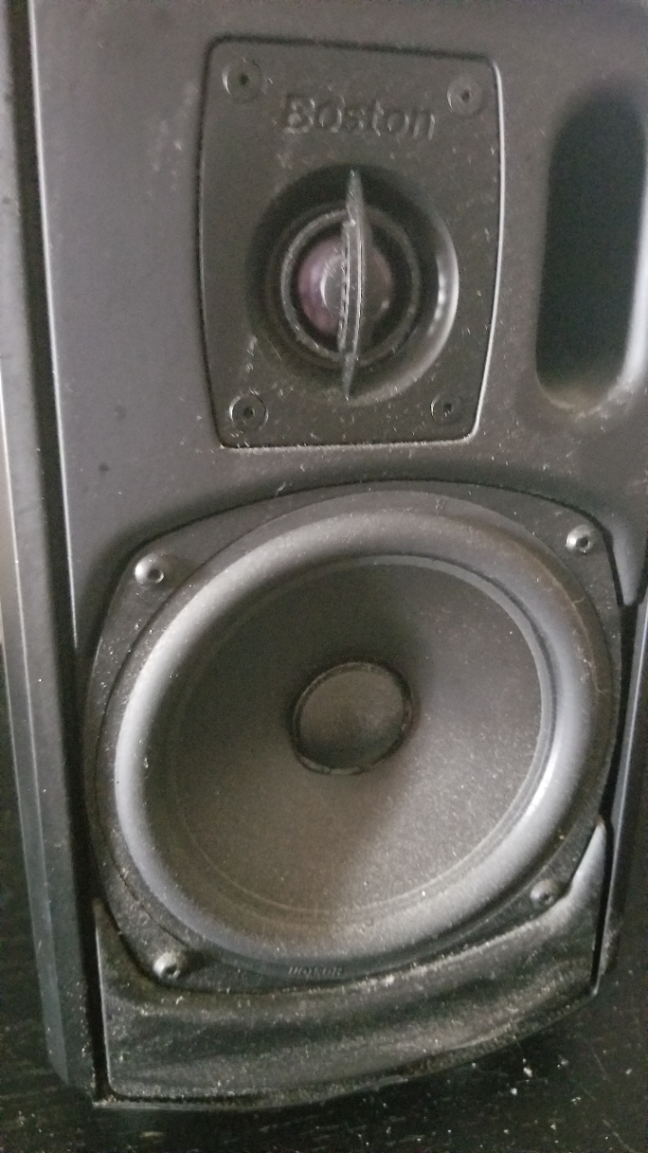

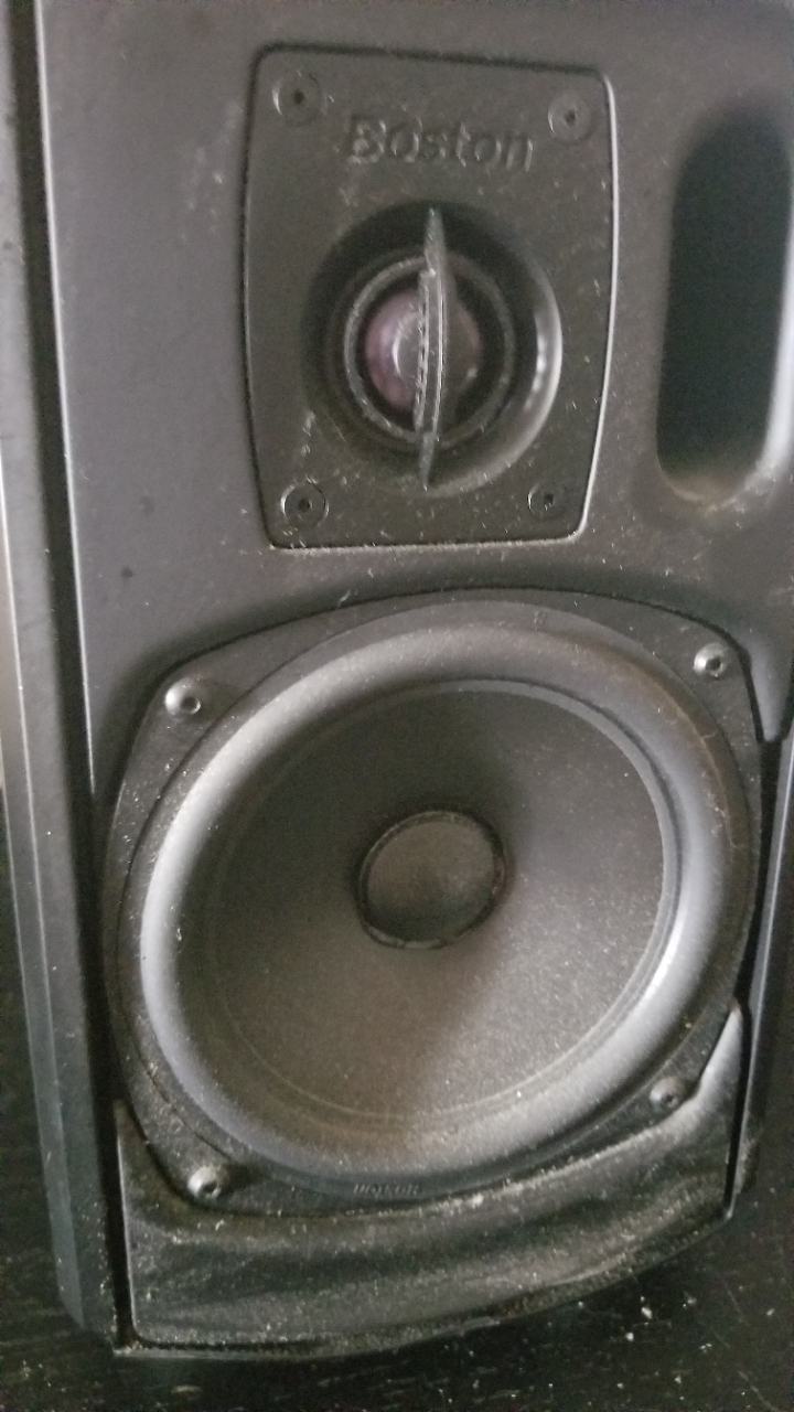

Found them in the garage
Not to keep hijacking the thread, but I'd bet the woofers are the same. The cabinets would make a fun project speaker when time is available, or definitely make good surround speakers.
