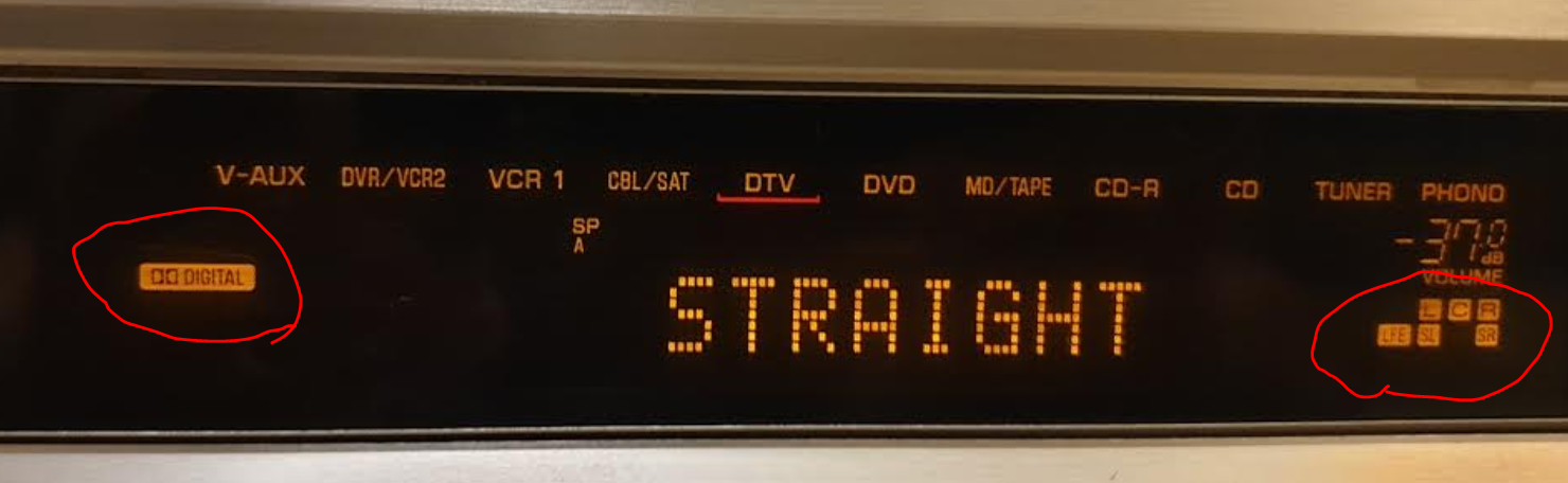

Update: I manage to get it working!!
I don' know how I missed it.. it was in the TV options.
I thought "DTV audio setting output" was the only setting in the TV, but you can also get into the sound out of the optical setting - it was set to PCM.
Long story short - You can get Netflix to work with plain DD on an old model receiver.
I feel terribly sorry for wasting your time guys, however I hope other people could use this thread to deal with a similar issue.
I'm feel terribly sorry for wasting your time guys, however I hope other people could use this thread to deal with a similar issue.
Thanks
Daniel
I knew it. Fantastic glad you got it sorted out and don't worry about plus doesn't add all that much. Enjoy.
