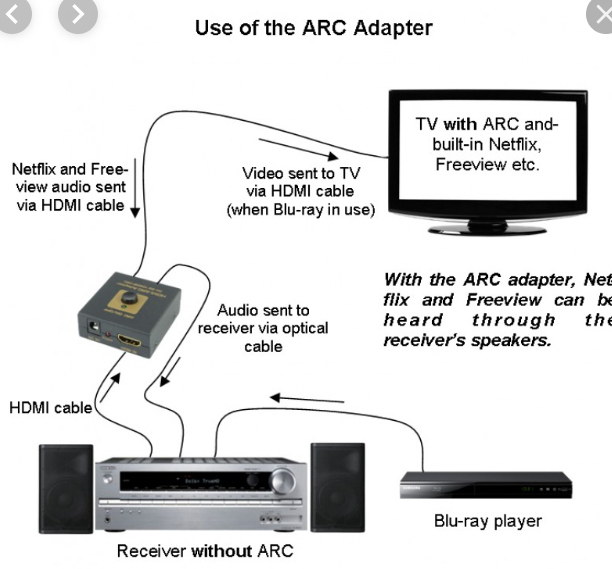

Searching the net for some more info I came across with this :
https://blog.son-video.com/en/2018/03/does-your-av-receiver-handle-dolby-digital-plus/
Claiming you need to use an HDMI arc. Perhaps I need some sort of hdmi->optical connector?
Also I wouldn't mind buying a dedicated streamer, providing it will solve this issue.
Thank again for the help!
j_garcia
j_garcia
Even if you adapt HDMI to optical, the signal will still be the same, AKA not 5.1.

Question is - could it be solved using a streamer or something like that:
Or connecting a streamer to this. Too bad there's no way finding out.. unless I'll find friend with a proper equipment
Before buying anything I would contact LG or just get a amazon fire stick 4k.
