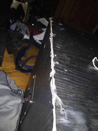

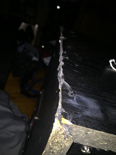

The product you are thinking of using is flexible. The cabinet should ideally be inflexible. So DAP is out. A wood glue, assuming the cabinet can be compressed using clamps, will provide a stronger bond than any other spot on the cabinet.
So some clamps or weight on the cabinet after applying the glue, to compress or close the opening, is the best solution.
Guess I’ll be returning. It for wood-glue haha !!

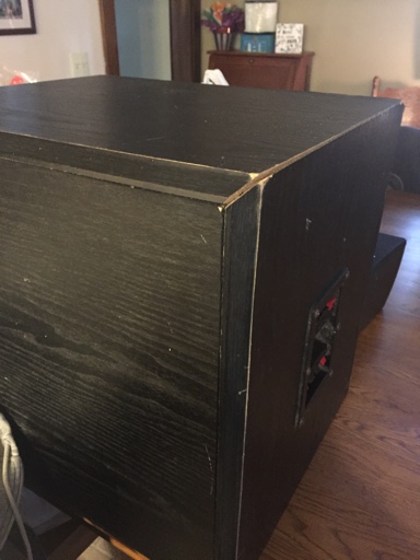

Save your money for some speakers. There's probably a lot more going on than a crack if there's water damage. This is another fruitless project that's more than likely not to turn out well.

Absolutely. If it cracked due to water intrusion then there will be some other damage that cannot be seen. Best to start saving for some speakers or at least the supplies needed for a DIY solution

Humidity cracked it , it was not submerged or even touched by water , are you sure the driver or the box is not worth using ? Or is this just a woofer sold as a subwoofer ?? I could put it in my car haha would a low end car amp power this junk thing ?

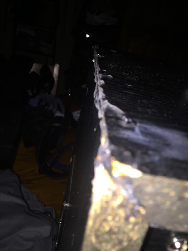

Ended up just using gorilla super glue .
