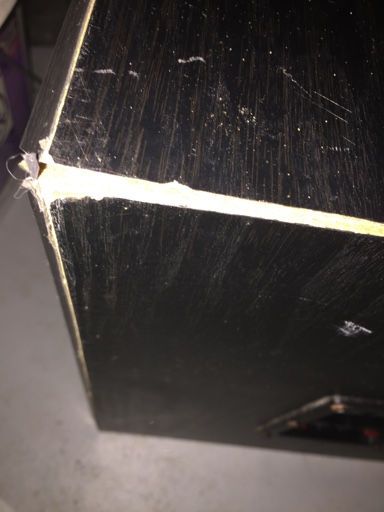

What would you fix these cracks with ? I was considering hooking it up to my car stereo .

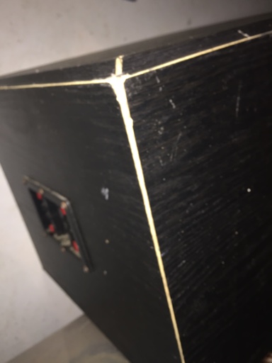

How would you repair this subwoofer?? Big crack in it

The box is shot... if it is humidity that did it in, the panels likely wouldn't even be in good enough condition to slavage.
MDF will suffer the same damages in high humidity, your best bet would be to build a new box to the exact dimensions of the old one using marine grade plywood. You can find some excellent reference material on the web for what goes into building a good quality speaker cabinet. Care and precision count.

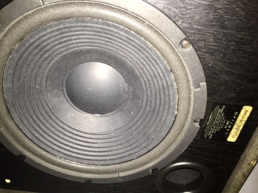

Going to cost a lot more then the sub is worth to build a box but the driver is well intact so it may be worth it.!! Don’t want to get rid of a perfectly good sub driver .

Squirt in some gorilla glue. 5 bucks.

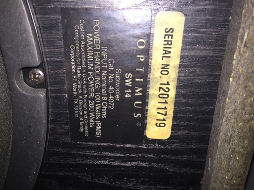

Good plan , what is this sub intended for music ? It’s a pretty wimpy sub for subsonic bass .

The product you are thinking of using is flexible. The cabinet should ideally be inflexible. So DAP is out. A wood glue, assuming the cabinet can be compressed using clamps, will provide a stronger bond than any other spot on the cabinet.
So some clamps or weight on the cabinet after applying the glue, to compress or close the opening, is the best solution.

I don’t have a big enough clamp but I can use something heavy maybe to wood glue it ?
