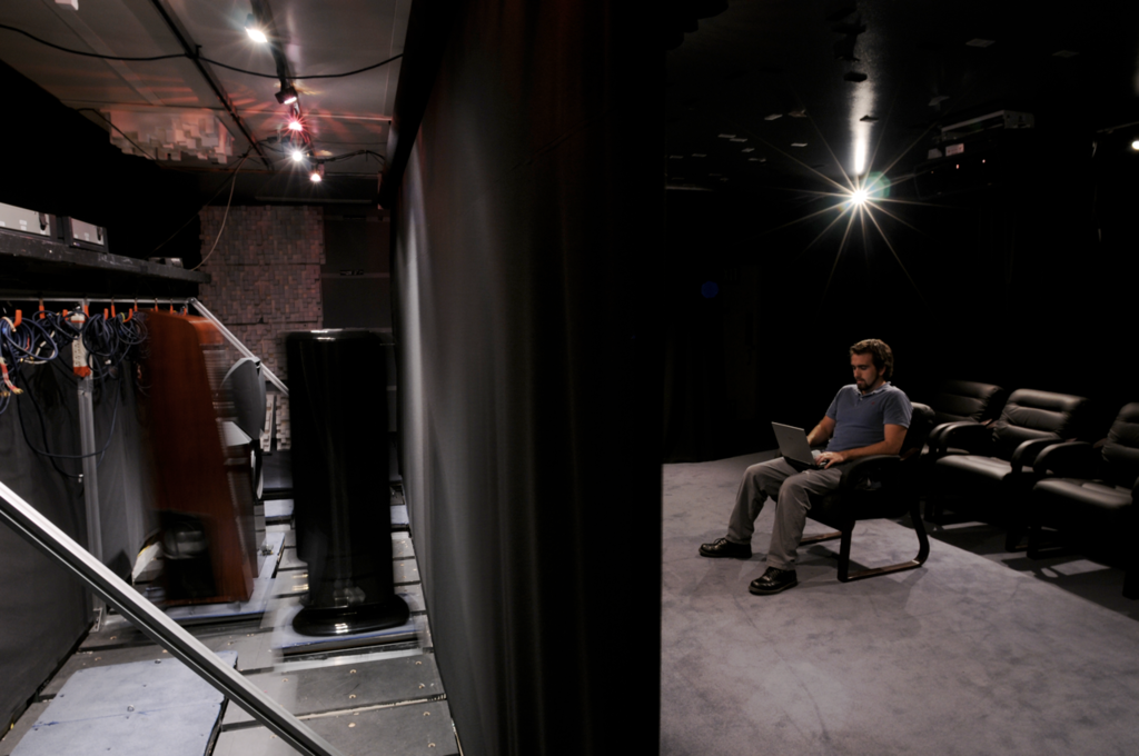

One thing worth mentioning is the second link @zieglj01 posted: that article illustrates the problems of an incorrectly performed d/b test. One thing Harman brings is a huge sum of money, so here is the infamous Harman 'Speaker Shuffler'.
The whole test is computer controlled with the user selecting a 1-10 score(to tenth place decimal) on an iPad for each of 4 speakers played in mono. (mono, because listeners are far more fussy with a single speaker, stereo listening can mask a lot of problems) The hydraulic shuffler repositions each speaker in just a few seconds while the listener stays behind a blind screen in a treated listening room. Each of the 4 speakers is compared in four different series where the music is changed and the speakers are shuffled - you never know what you're listening to. The results are then compared to show preference, but the listeners ears are paramount as there is a metric for how consistently you rated the same speaker in each of the four series. Bias is eliminated and any faults fall back on the listener, which is why they generally select and train listeners; You can actually download the program they made 'Harman- How to listen'. (very difficult on laptop speakers, I was only able to reach level 4 or 5 but some music would bump me back down cause I couldn't hear any difference)
Point is, and to the OP, science wins! All of the links I gave will provide exactly what you're looking for.
