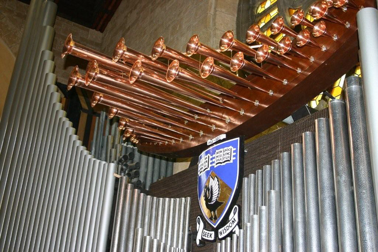

Yes, I would use TLs as they are Gedeckt organ pipes. To me putting those metal horns in front of the drivers does not make sense. This is an attempt to reproduce En chamarde reeds. These are fierce trumpet stops.

One of my favorite organs is the Harrison and Harrison organ in Kings College Chapel England. This I think is their absolute masterpiece. The primary function of English organs is accompanying the cathedral choirs. So great control is required. Here the 22 year old Richard Gowers puts the newly restored organ through its paces.
I mentioned in the previous thread how the enclosed divisions must present difficulties for samplers. Some organs are totally enclosed behind swell boxes. The English Builder John Compton only built totally enclosed organs. Only one example is good working condition that has not been mucked about is the one at Downside Abbey, Stratton - on - the - Fosse, Somerset, England. I know that organ well as I was at school there from 1960 to 1964.
The composer Percy Whitlock who came from my home town of Rochester favored the Compton instruments. My mother knew Percy Whitlock.
