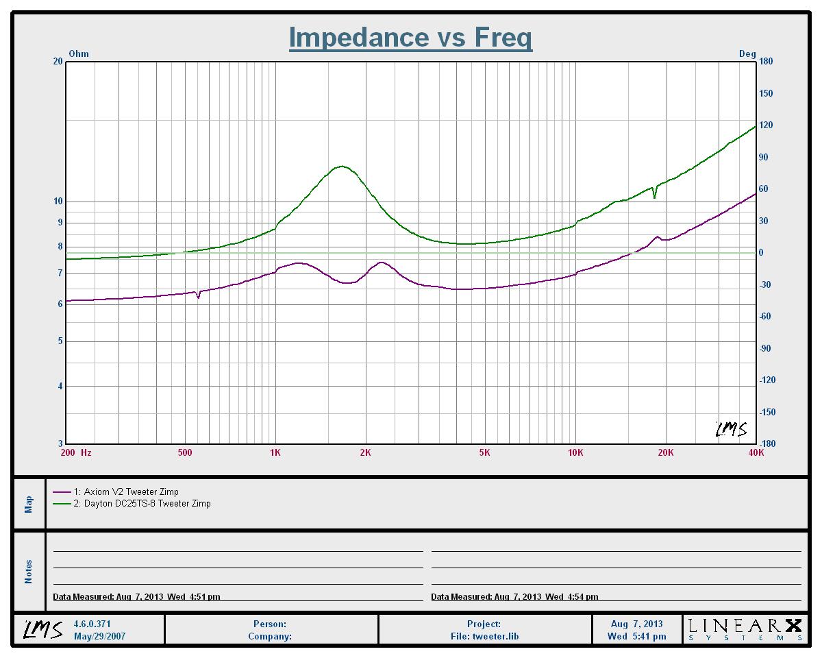

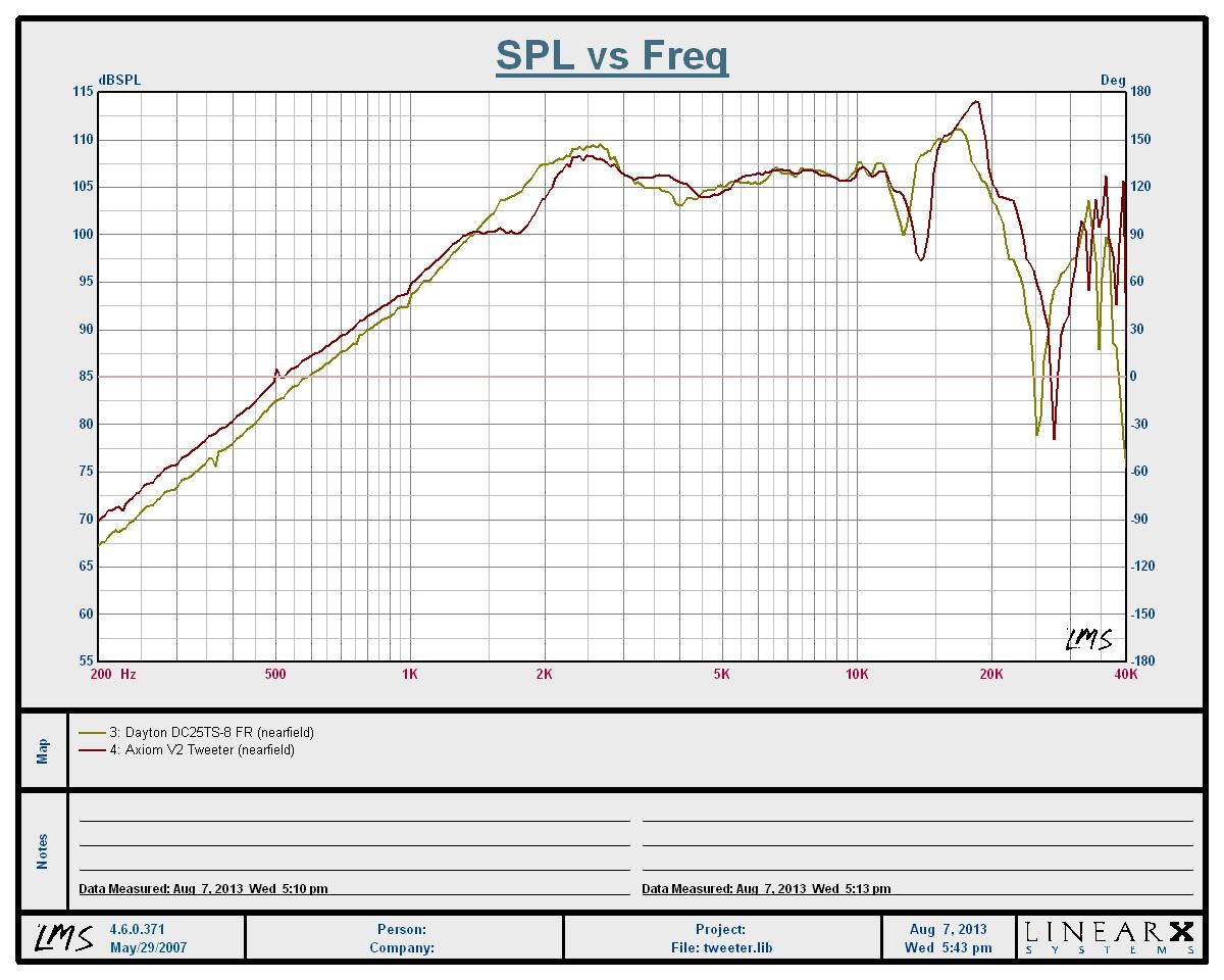

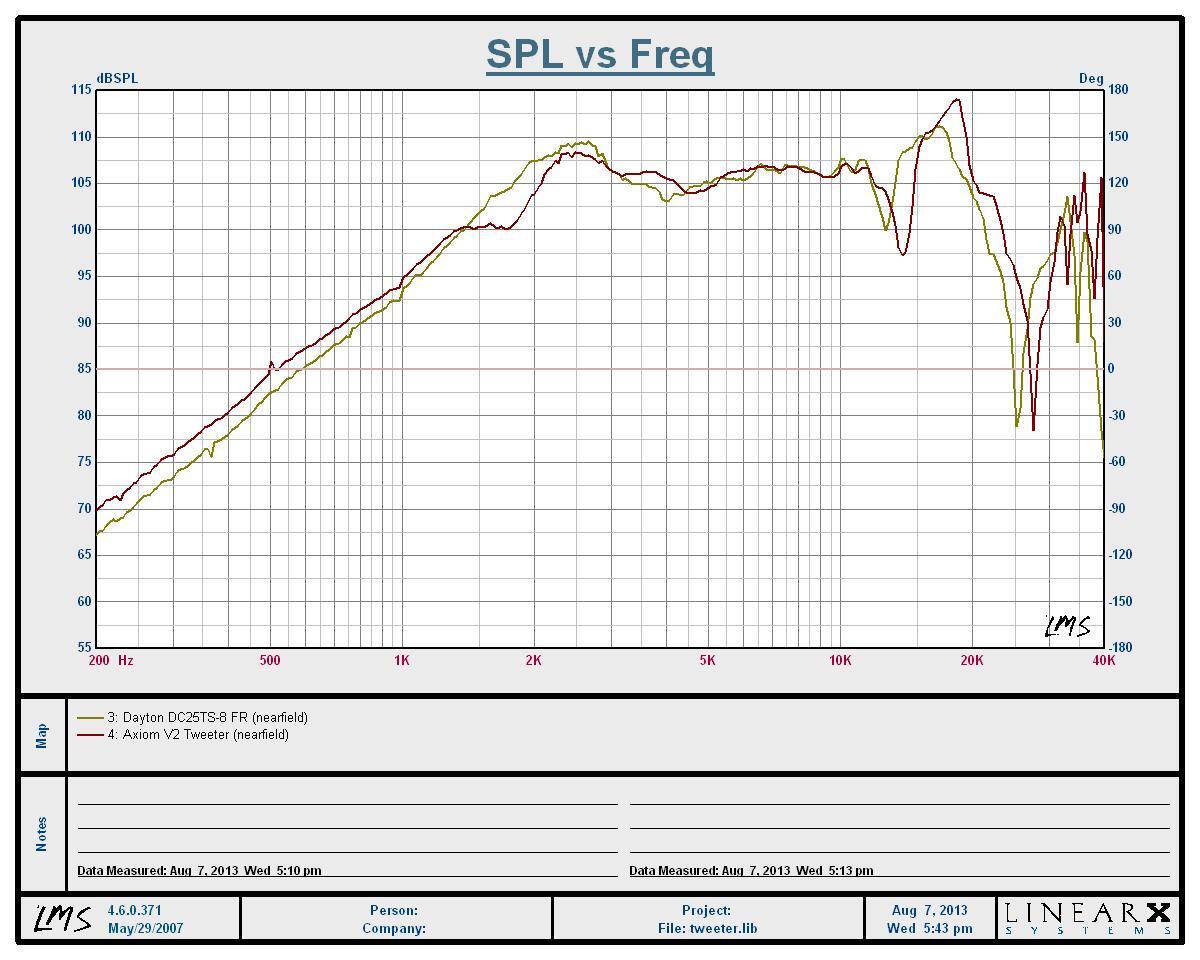

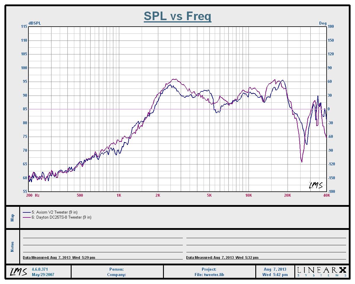

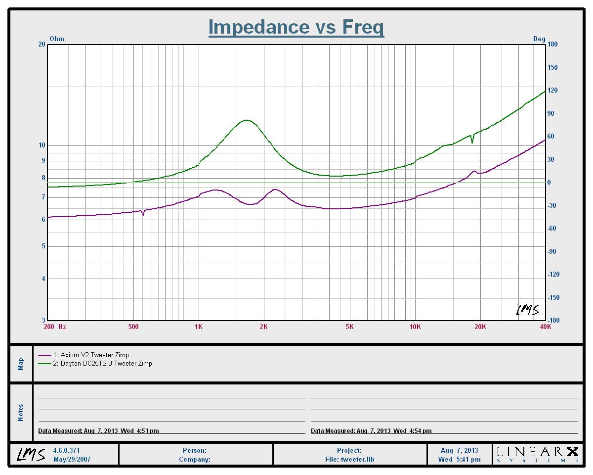

Dayton vs Axiom Driver
Thought I'd make a correction in this thread as it was mentioned that the Axiom and Dayton drivers were one in the same.
I was able to get a sample of the Dayton driver and compare it to my Axiom V2 driver found in my M3v2s I have on hand.
These drivers are NOT identical.
The Dayton version is 8 ohms while the Axiom version is 6 ohms. The Dayton version is unshielded, though they offer a shielded version. The Axiom driver is shielded.
It appears that the tooling/faceplate, dome shape, materials are very similar but the VC's are different. It is my opinion that the vendor building the Axiom driver in China offered a generic version of this tweeter to Dayton for sale, though I cannot confirm for sure. This is however very common in the industry and we have an article coming out about it next week.
I pulled some impedance and frequency response measurements (nearfield as well as at 9in distance) of both drivers to show the differences.
I hope this clears up the rumor mill at least on this issue.

Certainly not identical, but pretty similar in the range used. The Dayton looks better from 2-5k and the Axiom looks better from 10-20k. What was the test baffle, Gene?
Do the drivers look to have significant differences in power handling and xmax (underhung vs overhung, coil length, etc.)?
If the Axiom looks to have better power handling, I sincerely apologize to Axiom for claiming they use a wimpy tweeter.
What's going on with the Axiom impedance?
If they do, I sincerely apologize to Axiom for claiming they use a wimpy tweeter.
I measured both tweeters on the ground. I didn't bother to test power since my initial purpose was to validate the claim if the tweeters were identical. Clearly they have different voice coils. Down the road I can always build a baffle and do more tests but I think this is sufficient to show they are not the same off the shelf drivers though both have nearly identical cosmetics and somewhat similar performance characteristics.

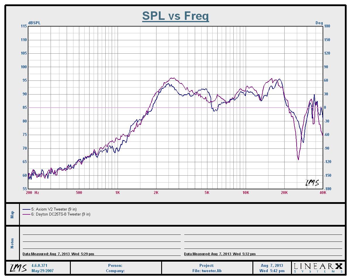

Twweters measured in am M3v2 on-wall
I measured the stock Axiom tweeter and Dayton tweeter when integrated into an M3V2 On-wall speaker. Both measurements were done with the same mic position 12" away slightly below the tweeter axis.
Again as you can see, they produce a different response.

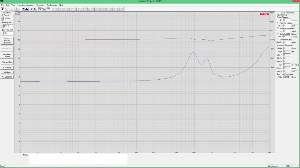

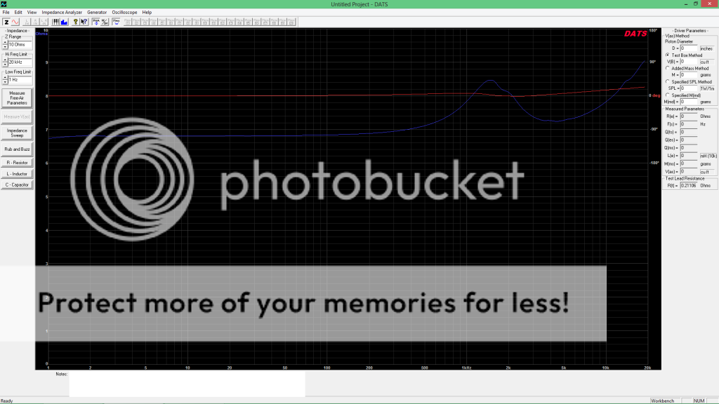

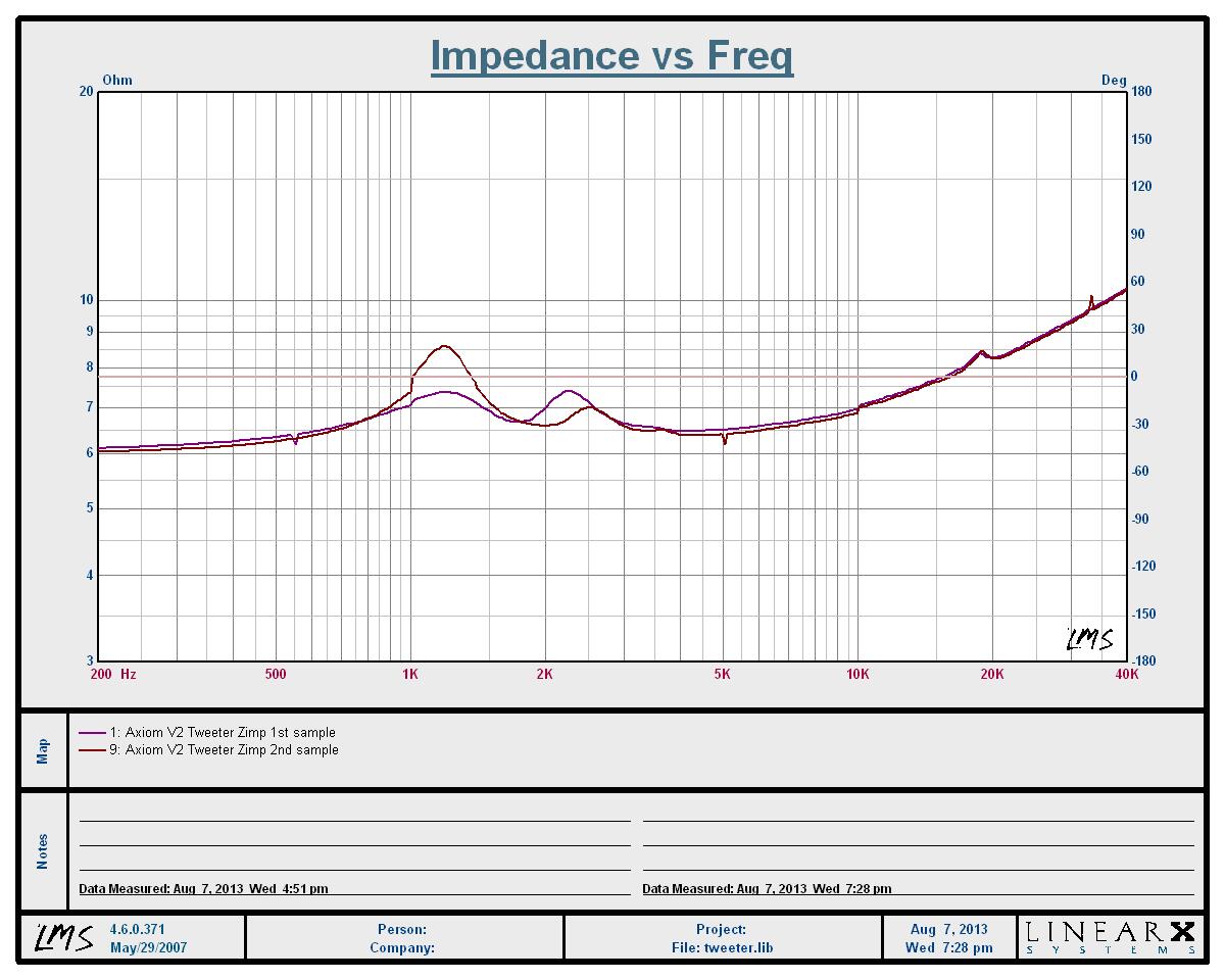

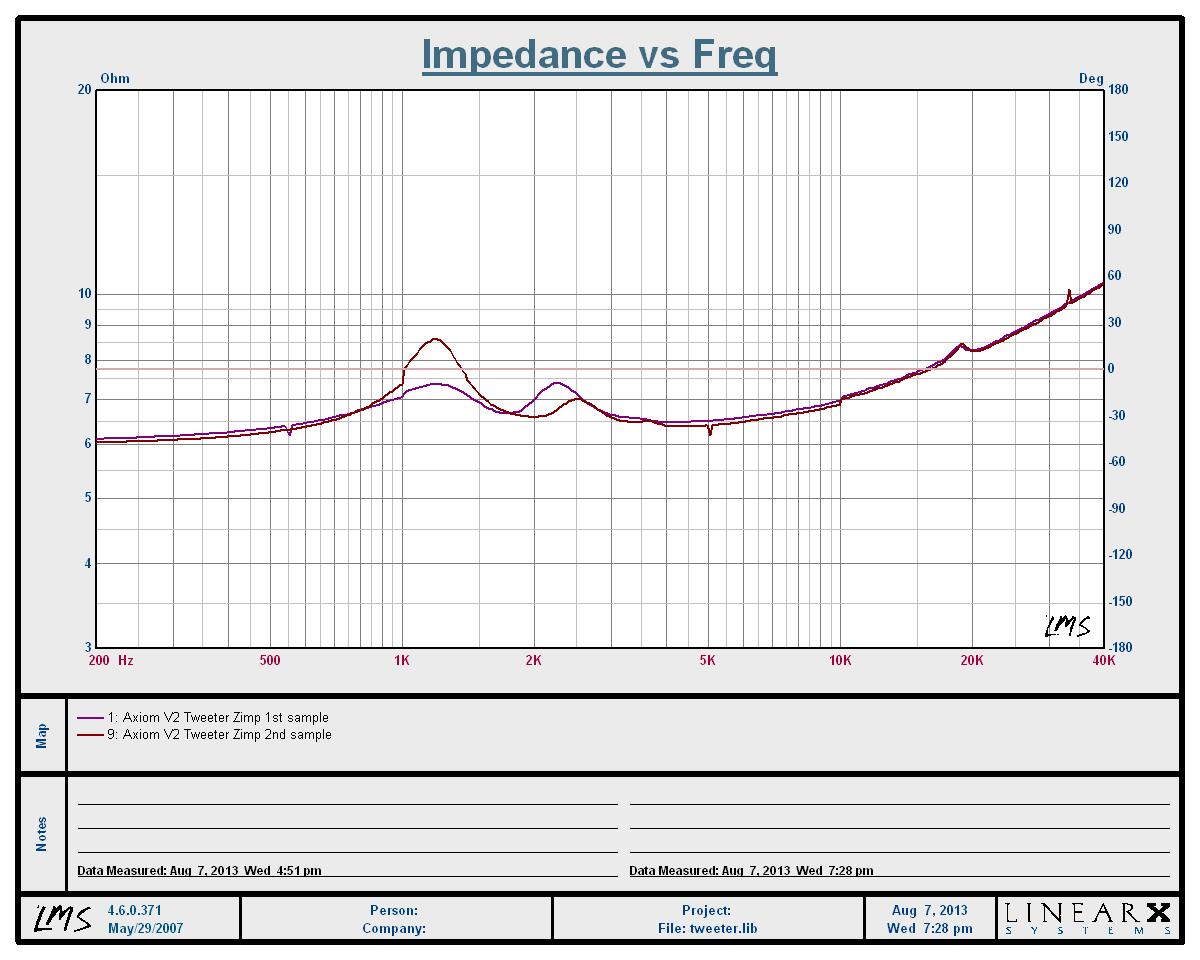

Axiom tweeter impedance
Not sure so i pulled the tweeter out of my other M3v2 on-wall and measured to compare. There does seem to be some differences in resonance which I can only guess has to do with the amount of ferro-fluid used in both samples?
I didn't see this variation when I measured the two Dayton tweeters but my Axioms are now 6+ years old and have been played for many hours.
OK gotta put the speakers back in the wall of our guest room as we have a visitor right now and my wife doesn't appreciate the mess :)
