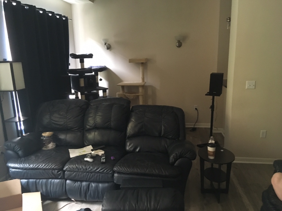

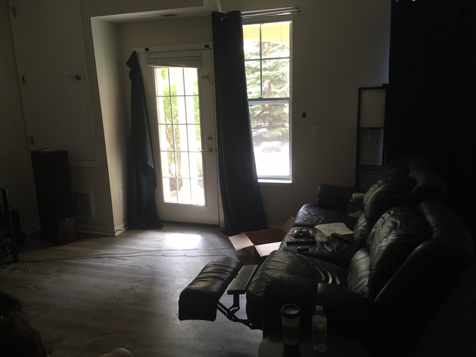

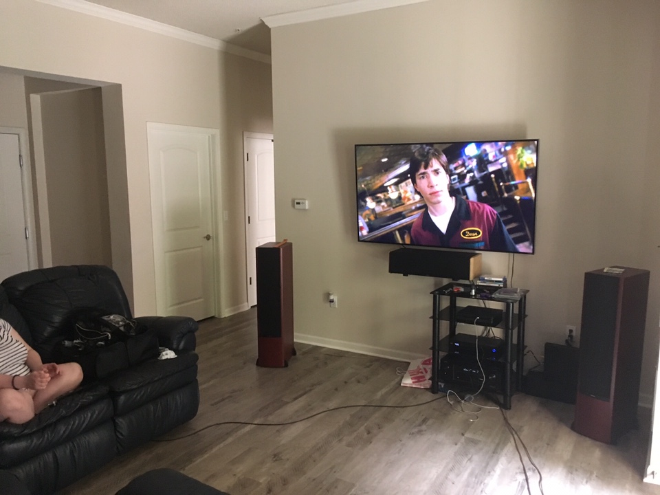

I need a lot of help picking out some great bookshelf speakers as well as a center for my new 3.0. I am willing to buy used for the right set up. I have a denon 3400 and 2 hsu vtf3 mk5 subs. I used to have Boston Acoustics VR3 mains and a VR920 cc. Now that I have the hsu subs I would really like to buy some high end book shelves that excel for movies where my subs cut off because I am 90% movies and 10% music. I would like to keep my budget at 1500$ for the front 3 but if there is 3.0 set up that is a large step up I’d be willing to spend up to 2000. I’ll add photos of my living room. My room is 17Lx 10Wx9H with openings to the kitchen and hallway to a bedroom.

I have a similar space, and SVS Ultra bookshelves, along with an SVS Ultra center, and dual ported subs, have worked very well for both movies and music. However, from your pictures, your room looks too reflective. You're probably going to need some room treatment to get good sound -- carpeting, panels, etc.
