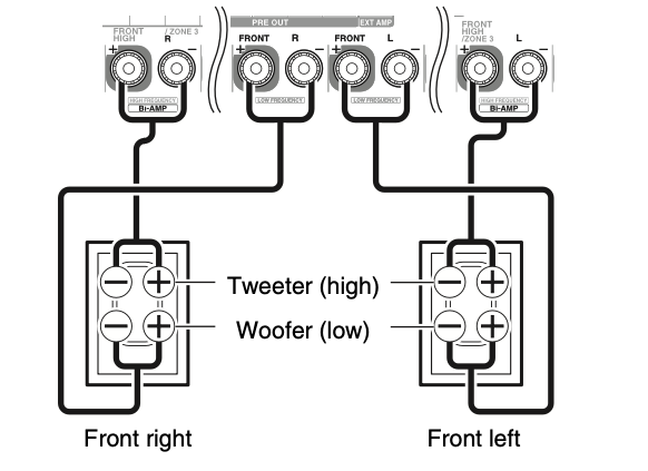

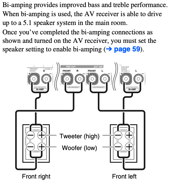

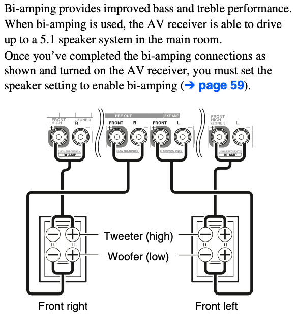

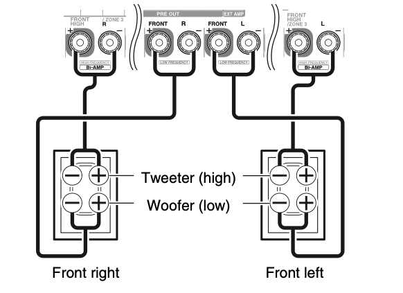

Each speaker is using 2 pairs of cables , just like this image . Thats how I was using the Bi-amp setup .
Each speaker is using 2 pairs of cables , just like this image . Thats how I was using the Bi-amp setup . View attachment 68189
That's what I'd not do any more. Just connect the L/R output terminals on the amp to each speaker and make sure the jumpers are in place on each speaker to prevent damage (probably strips with stock speaker but a lot of ways to equate that). So much bullshit involved with passive/avr "bi-amping".....just hook 'em up normally and if you really need more amp you have pre-outs to accommodate such....
