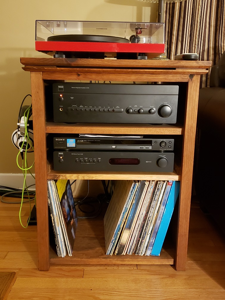

This is what I'm dealing with:
A normal footfall in close proximity to the stand will cause the stylus to skip. I may be wrong, but I'm thinking that the softest durometer over the widest area would provide the best chance of success. I would accomplish this by placing a sheet of 1/2" MDF on top of the sorbothane*, with the turntable sitting on the MDF. The MDF would distribute the weight of the turntable over the sorbothane, providing the most absorption with the least compression of the sorbothane. Does that make sense?

Looks like similar flooring to our war time bungalow. The root issue is likely deflection in the floor joists, which I'm sure you are aware of. Is it a finished space under the floor or would you have access to the joists? Doubling the joists would firm up the floor, assuming there are no gaps between the flooring and the sub-floor and the joists. If you can't do anything to affect the structure underneath, then it comes down to isolating the turntable from the cabinet. I think what you have in mind makes sense as you need mechanical isolation. Does the article touch on isolation platforms like those by IsoAcoustics (zaZen)?
My house was built in 1960. The joists are 8" with a 10' span to the centre beam. So, the floor has a bit of spring to it. I can access the joists underneath, but the furnace and hot water heater are right under the affected area, which complicates doubling up the joists, especially with all the wiring, plumbing and ductwork. So, yeah, I think I'll just try to do something with the TT support.

@GO-NAD! , shame you can't utilize a wall mount approach, that looks like an outside wall behind your rack, perfect !
GO-NAD!
GO-NAD!
Yes, that is an exterior wall. I say it's not an option because I don't believe SWMBO would entertain the idea. That said, she can surprise me sometimes. So, perhaps I shouldn't completely discount that option yet. This will have to be tackled in stages. First I need to address vinyl storage.
The cabinet behind the component stand in the photo above is where I'd like to stow my vinyl. However, it's too shallow for the records to sit properly. It has a twin on the other end of that wall. They are built-in and flank the fireplace. I would need to pull them out and rebuild them to suitable dimensions for vinyl storage.
Following that, I would modify or replace the component stand. It's 24" deep, which is way deeper than it needs to be. But it was originally built to house my two 300-CD changers, which are visible in the photo (taken before I disposed of them). This is when we'll have to discuss mounting the TT shelf to the wall.
Regardless, I won't be starting on this until I retire next year. In the meantime, I'm going to try to address the skipping stylus issue as I mentioned in my previous post.

We have springy floors in the living room as well (our house is a decade or two older) that caused an issue with the turntable in certain locations. It's now in the basement on a concrete floor with subfloor, but I guess that doesn't help you much. ;) It's a bugger of a problem because the movement of the cabinet remains. Any chance of replacing the cabinet with a larger one that also accommodates vinyl? Weight will be your friend.
The long term goal is to store most of my vinyl in a separate cabinet, although I expect there will be some vinyl in the component stand. But, I'm not going to depend on that to dampen floor vibrations. To be clear, this isn't a high traffic area and the stylus skipping isn't a constant annoyance. I'm going to try to mitigate the issue, but I'm not going to lose sleep over it.

I still think you would benefit from a high mass platform under the turntable, isolated from the cabinet, as mikado and I have done as described upthread. Perfect? Perhaps not. Mitigate the issue? For sure.

Very similar from my old place...
I would start with a very large concrete paver under the rack/cabinet (mine was 60cm x 60cm), sitting on top of either 4 or 5 large sorbothane pucks...
That was the single step that made the biggest difference on my unsprung turntable.
(my sprung turntable handled this type of setup fine without needing the additional steps)

Not sure a concrete paver is gonna be something the missus will happy with. Correct me if I'm wrong, but I would think that the more weight you stack on the sorbothane pucks, the more they will compress, reducing their capacity to absorb vibration. I suppose it's a function of matching the mass with the durometer rating of the pucks...
Yes it is - You can also balance it by having more pucks.... so you start off doing your calculations with 4 pucks, but you might end up with 5, 6, 8 etc...
The concrete can be treated with oil, painted, etc... I treated it with a hardening wood oil which would penetrate and then harden and seal - it worked well... others might prefer alternate treatments - if you can find a large enough ceramic tile that could work, or a piece of marble benchtop of the right proportions....
