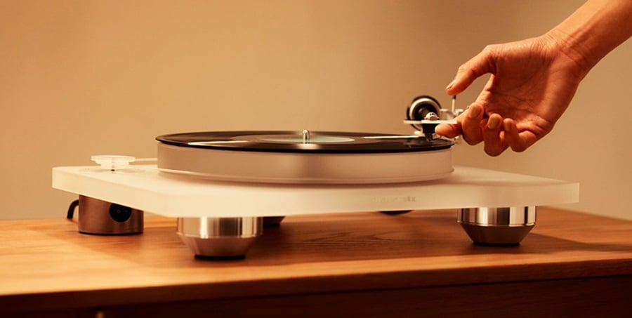

What a coincidence. I've been wondering what material to use under my turntable to stop the needle skipping when I walk around. If I step lightly, it's fine. But, a "normal" step within about a metre is guaranteed to cause a skip.

We had similar problems. The solution I implemented is similar to what @Mikado463 did, only instead of a butcher block I used a granite slab (leftover from kitchen remodel, it was the sink cutout from the new countertop). The slab was further isolated from the rather heavy credenza it's on with three of those ballistic gel stress balls you find in the checkout lane at the local hardware store. Under all that weight, they pancake out such that they're not visible. Between the slight squish and all the mass, it's now capable of withstanding a clydesdale dance party.

Mount the surface the table sits on to the wall. That surface, even if it's a dresser needs to be off the floor. I've done it that way for years.
Again, agreed, a much better option that a glorified 'swing set and a chain' scenario. With my situation my man cave / audio room is down stairs so with concrete I don't have to worry about floor movement.
